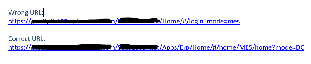

  1. If the browser session closed was MES and you re-launch the MES URL, it is redirected to the link for full Epicor and opens the Home Page. However, The license being consumed shows as DataCollection.
This was due to my MES URL being incorrect…even though it did open MES. Once I updated my URL per KB0115492 - the redirect was no longer happening.
https://epiccare.epicor.com/epiccare?id=epiccare_kb_article&sys_id=56b2eb8bdbd43990d426576ed3961932
To be fair to the KB, they state the following URL consumes a default license:
…/Apps/Erp/Home/#/login?app=MES
We are using the …/Apps/Erp/Home/#/login?mode=MES URL and finding that it does consume a DC license.
We’re just having problems with it logging in to regular/full Kinetic after logging out of MES and trying to re-log in from the logout page. Not sure, yet, if that’s an us or an Epicor issue (or browser, I suppose).
Have you tried using… /Apps/Erp/Home/#/home/MES/home?mode=DC
instead of the … …/Apps/Erp/Home/#/login?app=MES
Yes, I did (never stated to use app=MES, but rather mode=MES). Should’ve mentioned that. Got the same logout/login behavior. I didn’t test the mode=dc to verify it consumes a DC license, but if that is what Epicor says and what you said, then I’m inclined to believe it.
