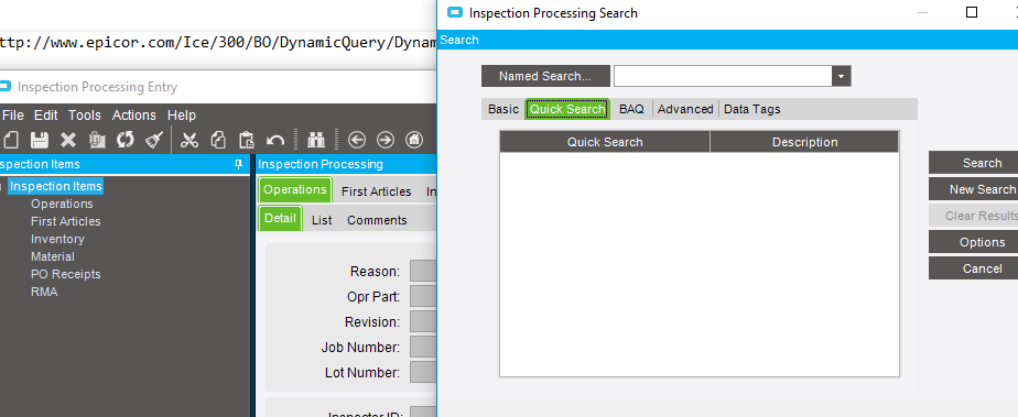

Looking to add a quick search to inspection processing entry. All I have is the binocular icon so I can’t follow the typical documentation on how to create a quick search.

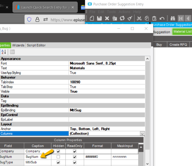

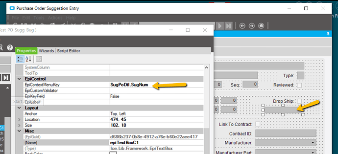

1- Add the field SugNum to the grid or add a textbox binded to this field in a temporary customization
2- Right click on the field - quick search

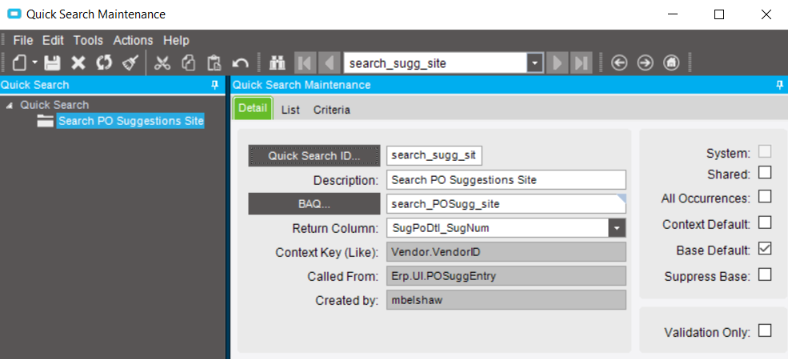

3- Create your quick search and check the Base default check box, otherwise it will never show. This problem seems to be specific to the New Po Sugg menu
