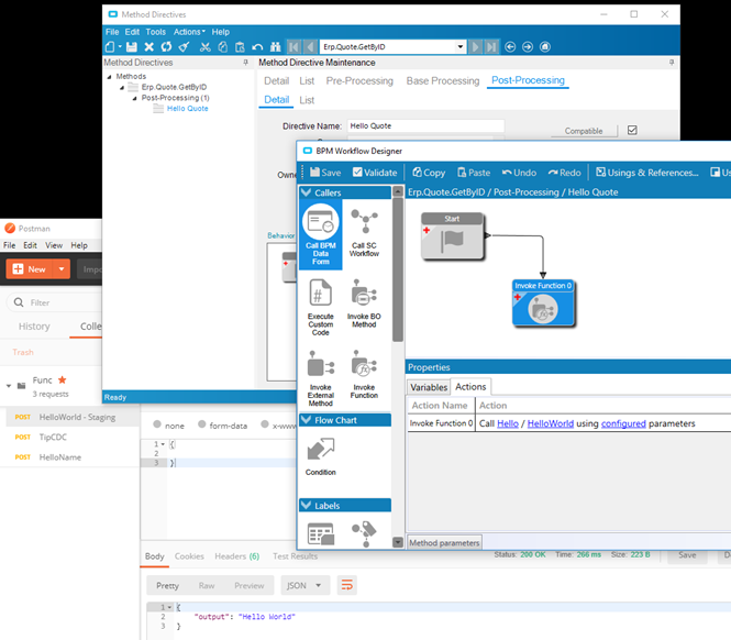

In 10.2.500, there is a new flavor of Business Process Management that sits alongside Method and Data Directions - an Epicor Function.
Familiar BPM Environment
Functions maintain the familiar. In a BPM, you can select a service, a method and change logic before, after, or instead of the normal processes in ERP. The data inputs and outputs are predetermined for you based upon those existing methods.

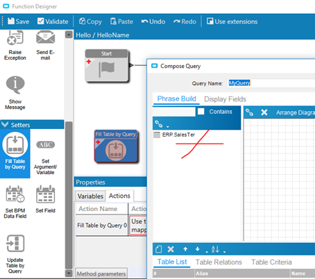

In a Function, you get to choose what signatures you wish to expose. After that, the designer experience is very familiar. You can create your own processes and logic.
This logic is then callable from within ERP or externally via REST

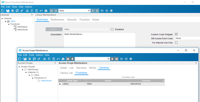

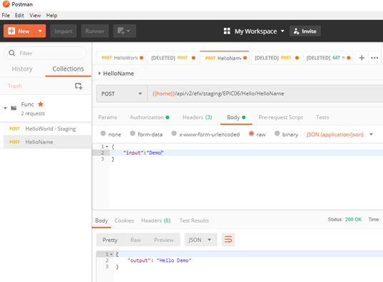

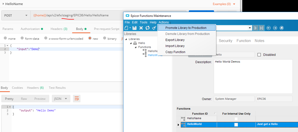

As a developer, trying to create ad hoc functions is powerful but managing those individually can be cumbersome for operations. To solve this, the concept of a library is there to bundle the different functions together. You can think of a library as a service or DLL that all your functions are combined together to make a unit of deployment. The URL to your function is familiar to REST v2 users
~/api/v2/efx/<YourCompany>/<YourLibrary>/<YourFunction>
This minimizes the potential conflicts when multiple groups create functions with the same name. Name your libraries uniquely and then consumers of your libraries will not have issues using your functions.

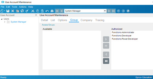

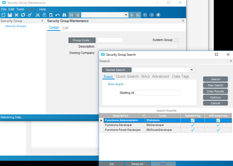

Starting in Functions, ERP is trying to step towards a few better practices that fit a modern Dev Ops mindset. To start with, three new roles are created:
• Function Administrator
• Function Developer
• Function Power Developer
The Administrator cannot touch the Function, a Function Dev cannot touch administration and deployment handling and the Power Developer role is required to write C# code in a Function.
Additionally, instead of adding three new Check Boxes to the User Maintenance form, security is set by adding users to the new System Security Groups
Another aspect to the DevOps mindset is that Function Libraries are ‘Promoted’ and ‘Demoted’ from production.
Once Published, a Function Library becomes read only to editing. This allows an Administrator to control breaking changes to consumers of the Function.

There are additional Security aspects available to you in Functions. To start with, you can limit usage of the Function to just support BPMs and not expose your process or calculation via REST. The ‘Internal Use Only’ flag will prevent the Function from being exposed via REST.
Additionally, the Access Scope understands Functions and their Libraries. This ability allows for the full granular access control that is supported by the rest of ERP.

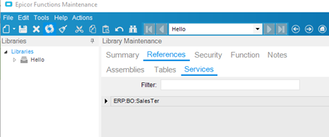

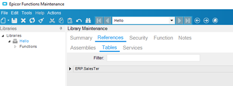

It’s no secret that ERP is a broad product with thousands of services and tables. Managing the migration between releases, the performance of the system at runtime and design time as well as the general struggle with usability when exposed to every possible table and service - it all can be overwhelming. To this concern, Function Libraries opt in to which Database Tables and Services a Function interacts.

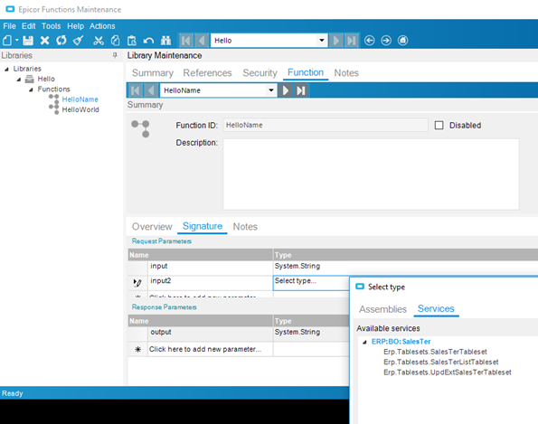

Your Signature
In your Function, since you control exposing your own processes and calculations, you can control the shape of the data you wish to consume and expose.
This data can then be used in the Function Designer and leverage in consumers of the Function.
