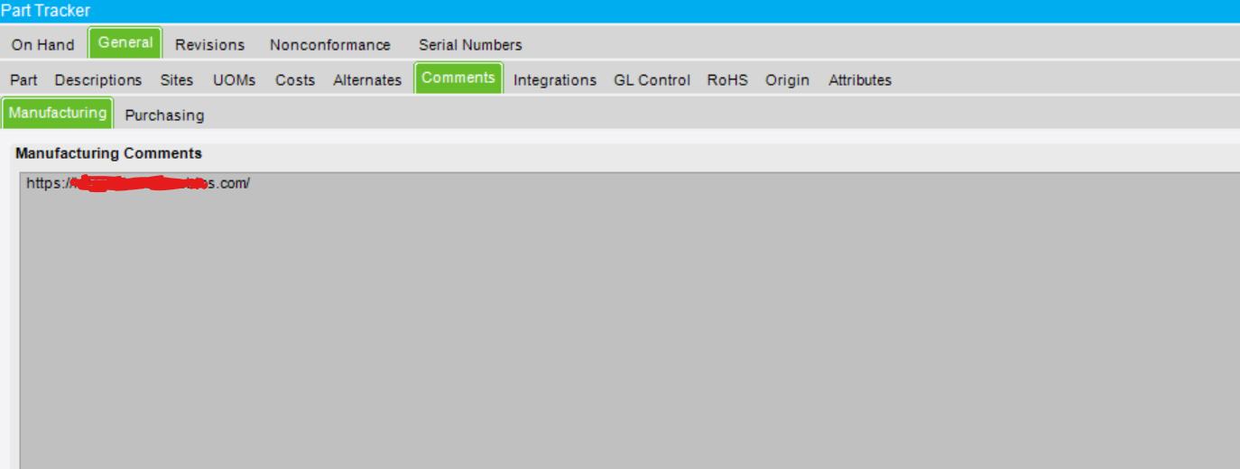

My co-worker would like to link to a website with more information related to the part. So I put the website address in the comment field inside Part Maintenance.
However, in the Part tracker, the website address appears as text only and is not linked.
How can I link to that website?

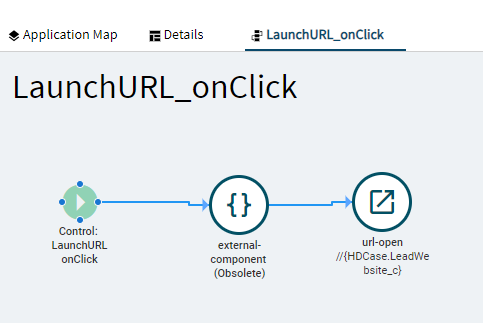

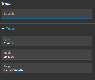

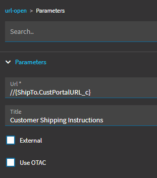

The field doesn’t matter, use whatever field you want. Setup a button, then in the ‘onclick’ event setup a ‘external component’ widget with target ‘launch website’ then setup a ‘url-open’ widget. Then change the parameters to point to your field. There might be a more updated approach but this is what worked over a year ago.

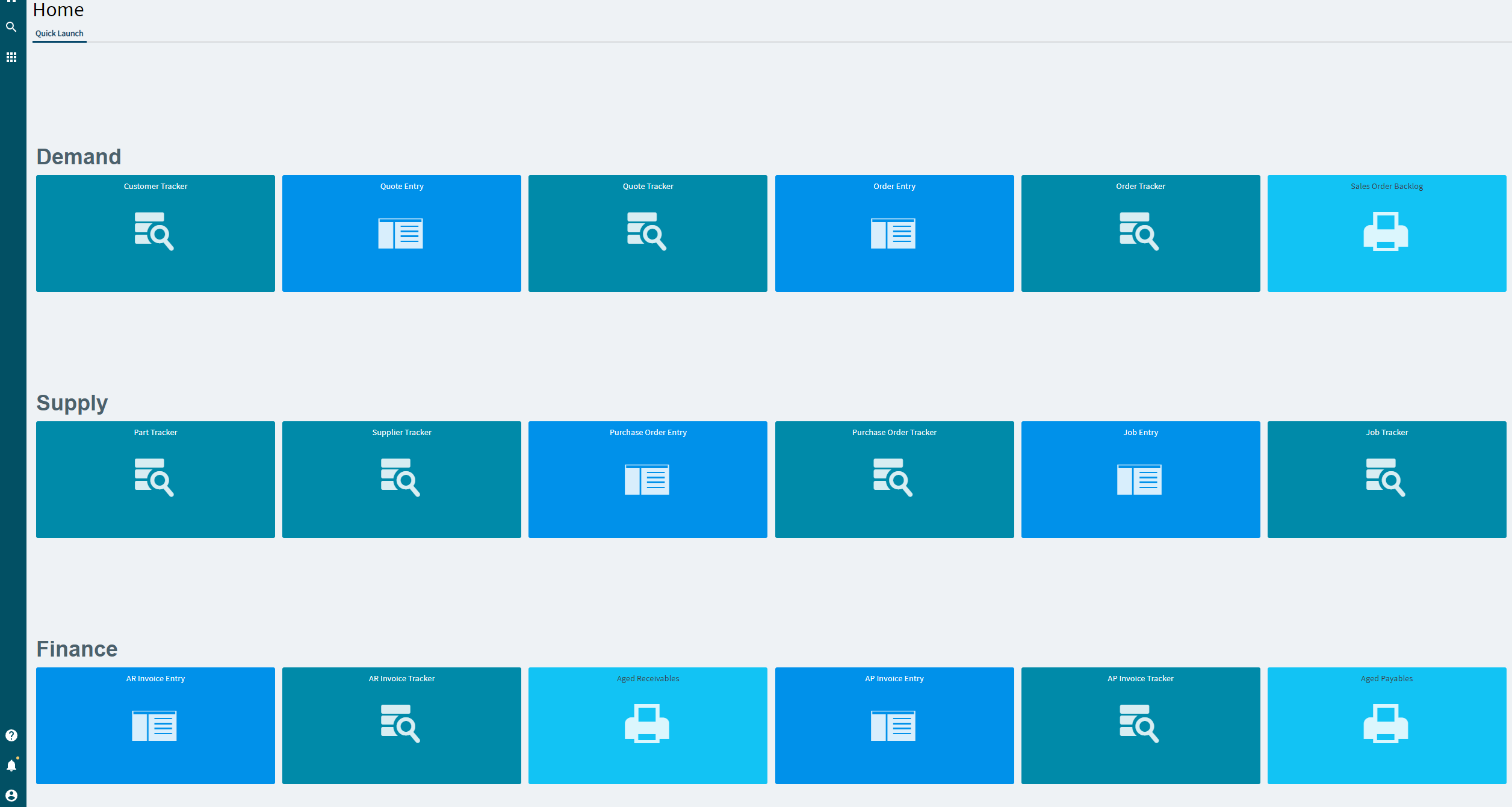

  1. I couldn’t find the route to set this up on my Epicor. On the screen below, where should i go?

Are you a system admin? If not, you won’t have any options available to you. If you are, then you need to utilize Application Studio.
I’m a system admin and have full authority.
This might help you.
Kinetic, Web Widget vs Launching external website - Kinetic 202X - Epicor User Help Forum (epiusers.help)
In your menu of kinetic search for Application Studio.
