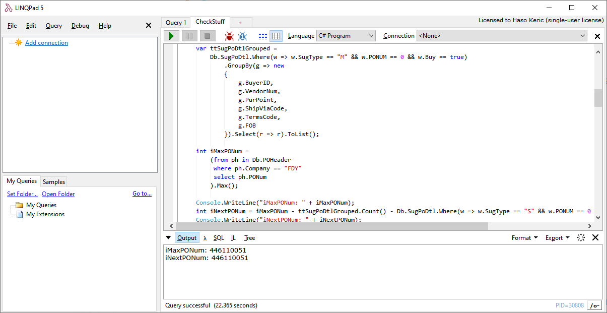

Here is a suggestion, stop using SQL Studio when you do any research, use LINQPad and LINQ and learn it faster :wink: its my SQL Studio replacement.
