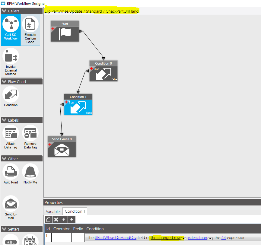

I am trying to set a data directive BPM to email me when stock for a certain part gets under a certain quantity level (100 units). This is currently how I have it set on the PartWhse table , but it is sending me emails when any part goes from a qty over 100 to under 100 units. Where am I going wrong?!
Check that the onhandqty has changed from Any to Any
and
the changed value is less than 100

what type of Data Directive are you using ? change your row status in both conditions to changed row instead of updated to cover both cases (new and updated), i have created yours in my Test environment as standard and it is working fine
I am using a Standard Directive on PartWhse.

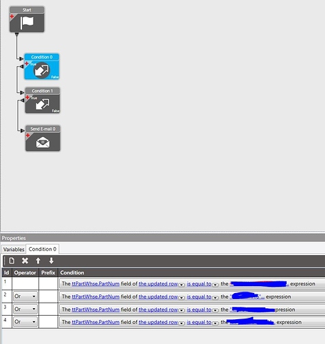

Odd thing is this BPM keeps firing on other partnums, not just the ones listed in the BPM condition.
Capture3
Try changing the “Updated Row” clause to “Any Row” and see if it helps. The problem is that there is not a changed row anymore in the dataset when it is a standard directive.
