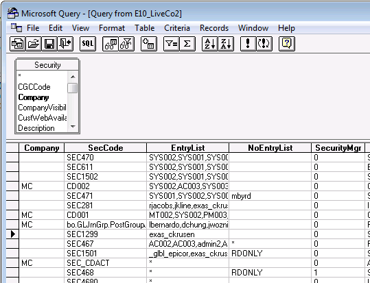

I just queried Security table in E10 and found it populated ( I know you said you’re going from V8 to E10).
Here’s a screen shot of MS Query of the Security table
The values in the SecCode are linked to each menu. The EntryList and NoEntryList fields list the users or groups allowed, or denied access.
