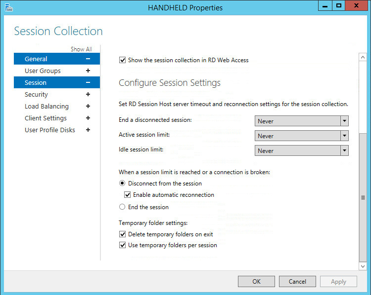

If your users connect their MES sessions through a Remote Desktop Services server, you can adjust their session parameters. Otherwise, I don’t know of a way to cause Epicor to do this.
The image below is an example of my handheld users. Note that I don’t have timeout restrictions in place, but it is a possibility.

Thanks Andrew, I will pass this on.
It’s worth a try.
