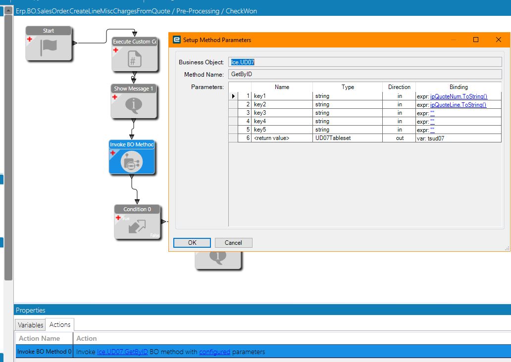

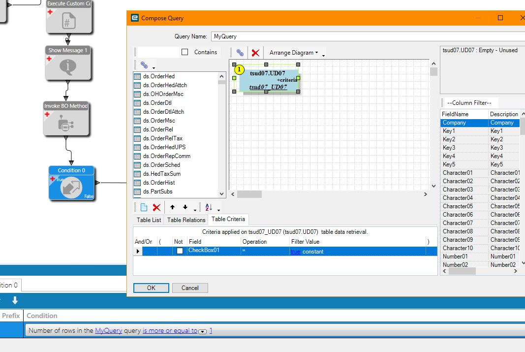

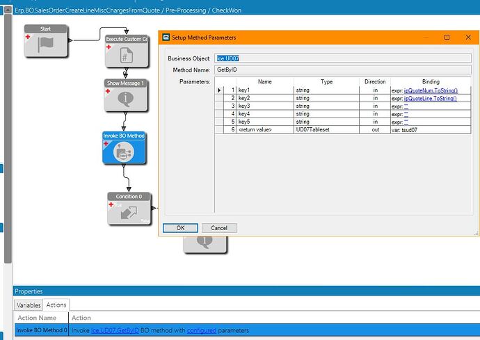

This all works great! Now I am trying to pop a warning to the person entering a sales order line from a quote if the line has not been “won”. I am creating the warning in pre-processing for the method SalesOrder.CreateLineMiscChargesFromQuote.

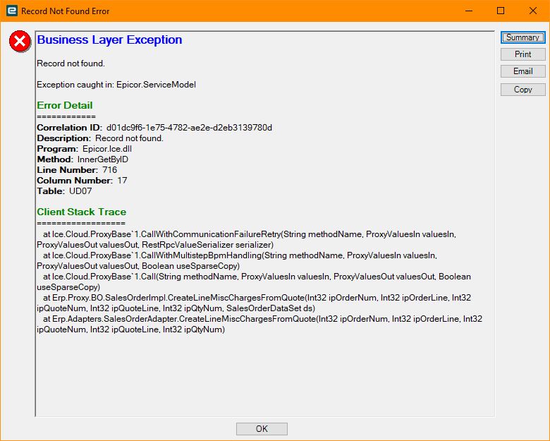

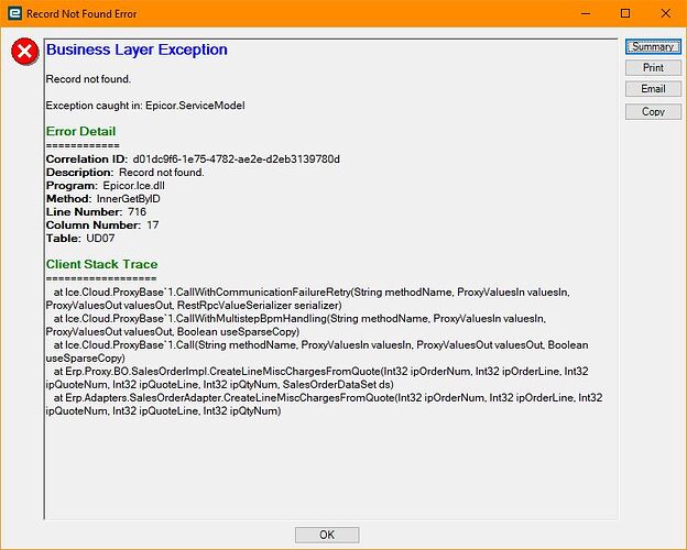

This seems like the right method, but when I do a UD07 get by ID the whole thing fails if there are no records. I would think my if widget would catch that.
I want the method to work even if there are no records in UD07. But if there is not a record that matches quote and line, then pop a warning to the user.
It seems like it is failing with the error on getbyid.
What am I missing here?

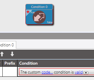

I’d probably stick that code in one of these:
“Valid” is a misnomer. If your code returns true, the BPM will follow the true path on the condition block. If it returns false, it will go down the false path.
Add “return” to the beginning of the code snippet BTW.
