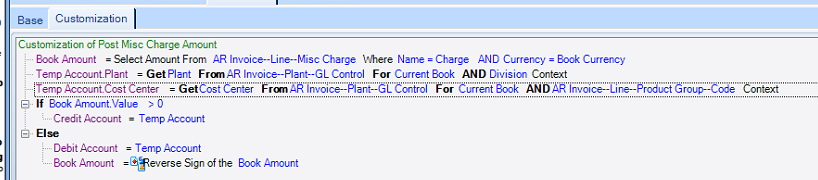

@Mark_Wonsil Posting Rules have come a long way. They are not your Dad’s rules anymore. :slight_smile: The regular rule runs first, then the custom. We have one on Misc Charges that uses a Lookup table and that would work for this, but you would have to update as product groups were added. I tweaked it to the below that I think would work if I am following where the department comes from.
Greg
