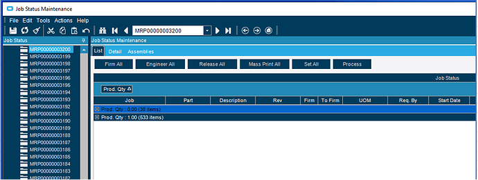

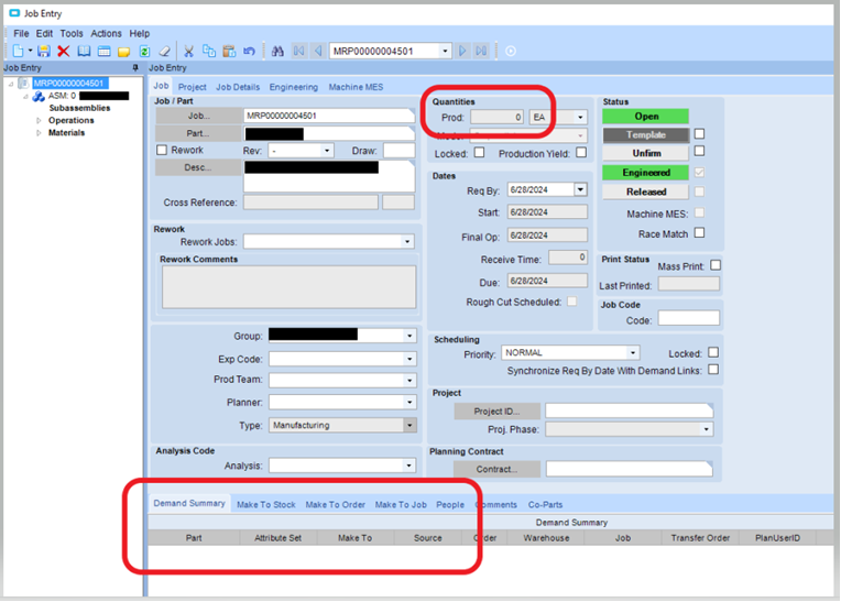

We are running Epicor 10.2.700.39 on prem. We recently discovered an issue with our MRP runs. It seems that since last November we have MRP jobs being produced where the Prod Qty = 0. The number of parts and the specific part numbers varies each time. When we check the MRP logs, the log shows it has created the MRP job with Quantity 1. (Our parts are set up with Min/Max Lot Sizing set to “1”). When we review the un-firm jobs by part number in Job Status Maintenance, the MRP jobs display with Prod Qty = 0. Opening up the MRP job in Job Entry also displays Prod Qty = 0 and the demand link is blank. We presented this to Epicor Tech Support and they requested a copy of our database so they could test. When Tech Support eliminated the use of all customizations and BPM’s on the copy of our database, the problem is resolved and they did not get any MRP jobs where Prod Qty = 0. They advised us to do the same. The problem is when we remove all customizations and disable all BPMs (data and method directives), we still get the MRP jobs where Prod Qty = 0. Epicor is now saying that they will need a technical person in Epicor Services to look at this. I thought I would bring this situation here knowing that some of the best Epicor technical people are in this forum. Has anyone ever seen anything similar to this or maybe see some things we can try to work toward a solution?

That’s the weird part. The MRP log shows that the Job is created with prod qty = 1. But by the time we look at it in Job Tracker or Job Status Maintenance it shows zero.

Open example MRP job – MRP00000004501 in Job Entry which shows JobHead.ProdQty = 0 and Demand Link is blank:
Are you using AUOM?
JobHead.ProdQty isn’t a primary field, it’s a summation of the child JobProd records. So, yeah, failure to write JobProd records will result in a Job with an overall qty of zero.
This exact line, I believe, is MRP trying to add the JobProd record. That it proceeds with the detail pull suggests that MRP thinks it successfully updated the job. Then again, I’m not sure if it’s actually checking to see if it wrote correctly.
