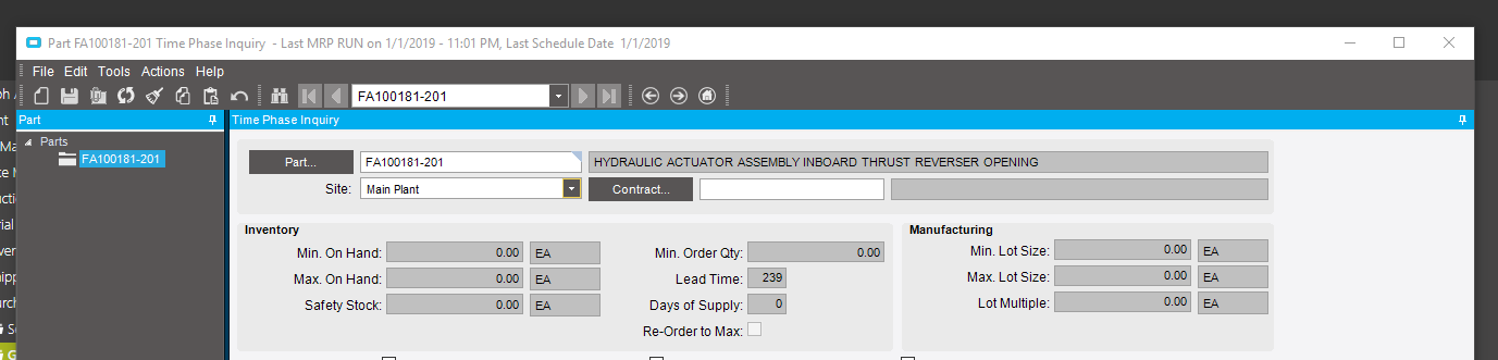

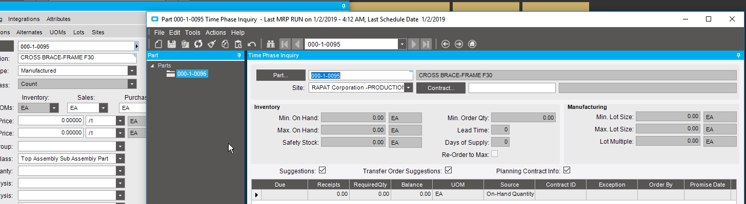

I have a part that is showing in Time Phase MRP ran on 1/1/19. We only ran PO Suggestions and this part is marked as MFG why would PO Suggesstions picked it up and ran it?
Part is marked MFG in Detail and Site.

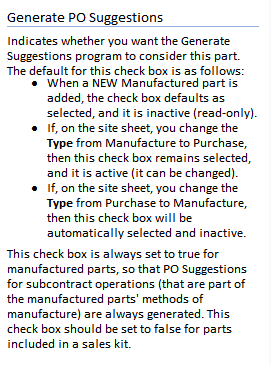

Here’s the help on the Generate suggestions check box. Looks like unless you specifically filter to certain parts, even MFG parts are going to run through the PO Suggestions Process.

nope the part that ran was a Top Level MFG part.
no sure if causing problems but the question was asked why is the part getting picked up when it is a top level MFG part not a purchase or subcontract part. I want to know why too. In my mind it should not have run on that part.

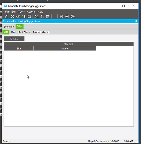

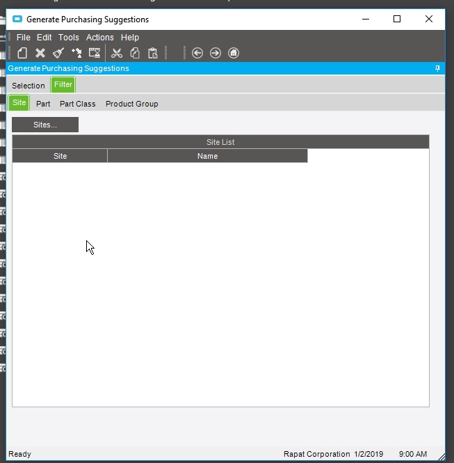

If you don’t pick a site, part, part class, or product group, it’s going to run everything.

It’s just a message letting you know the last time the system looked at it.
If you look at the Sites Tab, there is a checkbox that says Generate PO Suggestions. If this box is checked, when PO Suggestions are generated, the system will create a suggestion for that part. That is why using the filters to limit what the process looks at is important.
You can’t uncheck it if part is set to MFG. I even tried by changing it to Purchase uncheck PO Suggestions then change it back to MFG. Once you change it to MFG it checks PO Suggestions. I don’t remember E9 doing that; we recently went live on E10.
