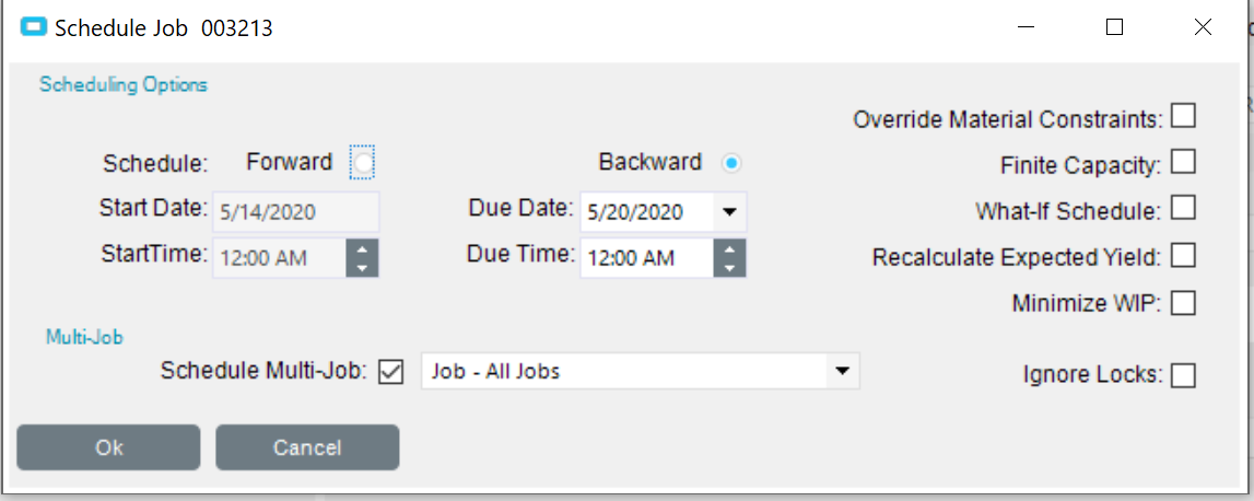

The suggestion would be to move a firm job from 6/30 to 6/16.
I go into the job, change the req date to 6/16 and run the reschedule. That will run and the dates will change. Then, the next day I see the same suggestion to move the job from 6/30 to 6/16
When I run the reschedule I always run it with no check marks like below pic.
How do you check if global rescheduling process is in use?
is it in your nightly schedule? You can look at the task schedule to see what ran last night… look for the Global Rescheduling task.
Our global reschedule runs nightly.
ok, that is what is rescheduling the jobs… if you lock the job’s schedule, they will stop rescheduling.
Some companies put a BPM in that automatically locks a job’s schedule when they Release (or firm?) the job. I have also seen companies set the lock schedule when the first labor transaction is done.
