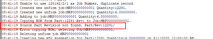

Getting the error below for a part in MRP however the revision most def exists and is approved. For some reason it’s trying to pull a blank rev. Rev is set on the Sales Order that is also set as make direct. Anyone else ever see this before?

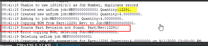

Also, is it just a coincidence that just prior to the highlighted error, the process tried to make a job with a qty equal to the Partnum in question?
This is the top level part. As far as the log goes I’m guessing that’s an issue with the logging and the label should be PartNum. I’m curious enough I may decompile and look at how they are generating that :slight_smile:

What’s the error on the first line of the screen shot? Is it trying to create a job in the Order-Line-Release format but it already exists?
We created a stock job to jam it through, but I still want to understand why its throwing the rev error.
In the case of the duplicate job number. If the job number for a make direct release is already existing it creates a normal MRP job with a regular ol job number vs the order-line-release number
Side bar | it’s a bug confirmed it in decompile they are using the wrong resource string. Instead of “Created new unfirm job: # Quantitiy: #” it should say “Created new unfirm job: # for Parts: #”
