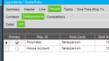

When I create a quote for a certain customer. It populates 2 salespersons. I cannot figure out why. I have one salesperson setup for that customer.

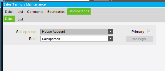

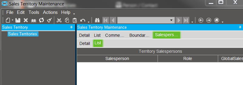

Check the sales reps that you have on the territory that customer is in.

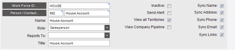

Uncheck the “View all Territories”?
It shows up there.
House Account is our default. Is there a way to just overwrite the sales person in a new quote with the salesperson of customer setup?
We have the same issue. With certain order of operations on creating a quote it will add a second sales person instead of changing the first one. I haven’t gotten around to re-creating the steps for when it duplicates and when it just changes it, but it’s on my list of to-do’s. We have been trying to make it so whoever is logged in (for the applicable users) it sets the salesperson automatically. It’s been harder than I think it should be.

My guess is you have the consolidate to prime rep checked on the territory. It will add the primary sales rep from the customer record and the primary sales rep from the territory when that is checked. If they are different, then you get 2 reps I think.
Our company has multiple salesperson showing on a quote when there is a Sale Territory with a primary Salesperson and the Customer has default Salesperson.
