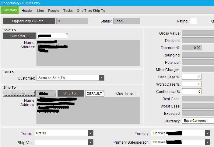

I adjusted a territory to reflect the new primary sales person for the territory. However, some of the customers in the territory adjustment will need to keep the old salesperson.
To do this, I did the adjustment and went back into the specific customer and selected the old sales person.
I saved the customer and created a new quote for the customer.
The primary salesperson from the territory defaults in, not the salesperson as defined on the customer.
I am scratching my head on why this would be. Both workforce member have the same role and according to the application help, the default salesperson on a sales order is defined on the customer. Keeping in mind this is on the quote level, is there something I am doing wrong? I do not recall having this issue before…

Is it possible that Chelsea is the Sales Person from the ship to?
If so, that is the problem.
You will need to update the Sales Person on the Ship To as well.
You can change the Territory Source on the Ship to to “Synchronize with Customer” so that when you change the Rep on the Customer, Epicor should automatically updates the Rep on the Ship To also.
Yep, that was it. Thank you Lacey!
So, I assume I will need to make sure all the customer ship to’s have that selected and probably run a DMT to set the primary ship to sales person, right?
Yes! Use DMT to update Customer ShipTo. The Column name would be TerrSelectFlag and update that field to the word SYNC
