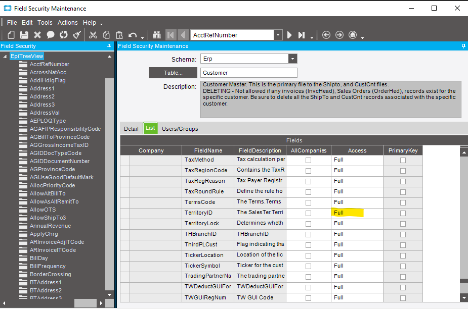

If you go to Field Security Maintenance, does this say full or does it contain users/groups?
It says Full currently.

While scrolling down the list, I saw that the field SalesRepCode was set to Read, not Full. Saved, logged out, then logged in as my test user…success!
Thank you for pointing me in the right direction
