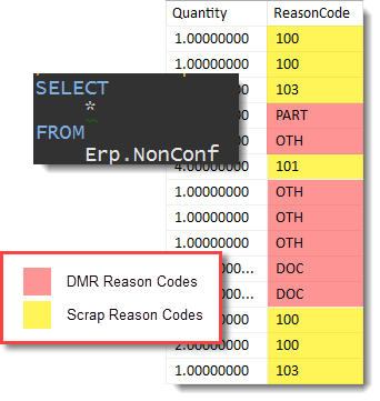

Might anyone recognize, under specific circumstances, when a “DMR” reason code might be used during a non-conformance entry (and more importantly, where this is done) as opposed to a “Scrap” reason code?
nonconf-reasoncodes
Might anyone recognize this pattern and be willing to provide some insight/education for me?

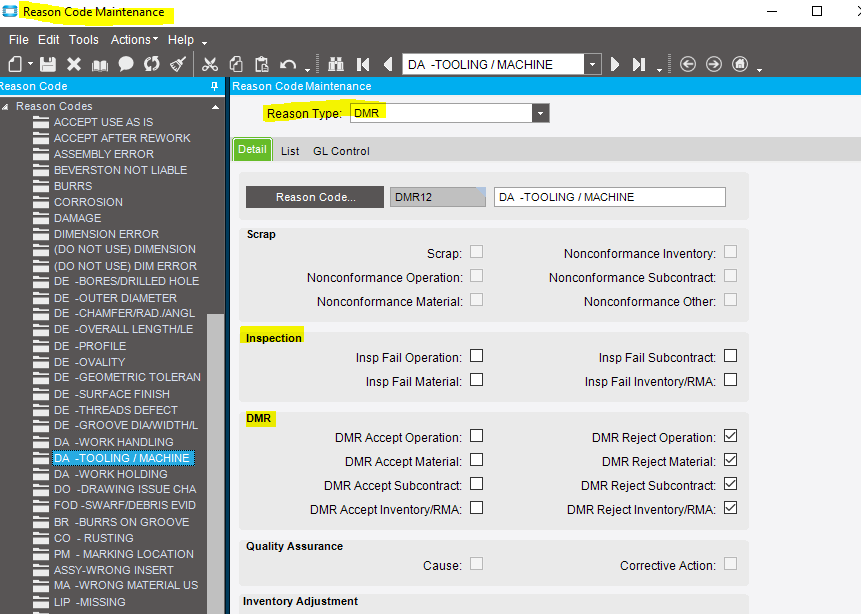

i am not quite sure what do you mean by “when DMR might be used”, however Reason Code can be set on Reason Code Maintenance UI, depends on Reason Type, you can control where can be used, i.e. for DMR reason type same reason ID can be used under Inspection and DMR processing, it is up to you, implementing Epicor Quality Module required Users to decide many things/rules within their working environment.
If you make a non-conformance entry, the Reason Code associated with it is a SCRAP type reason code. The system generated as STK-INS transaction. Your SCRAP
code is for documentation only. Once you part is in INSPECTION in can be failed and mover to DMR .DMR processing will use the DMR reason codes have associated GL Codes. A good reference is the E10 GL Hierarchy
What you are seeing in your BAQ are reason codes that come from failed PO receipts or failed RMA. The system automatically puts them in NONCONFORMANCE.

I did a quick test to make sure I understood the flow of data as you had described it and it makes sense to me now. I performed an inspection of 50 parts off a single Receipt Entry; 40 passing and 10 failed parts on the same receipt. The database showed a new record in [Erp.NonConf] for those same exact numbers, but with a “DMR type” reason code.
Thanks for providing the clarification. That helped me out quite a bit.

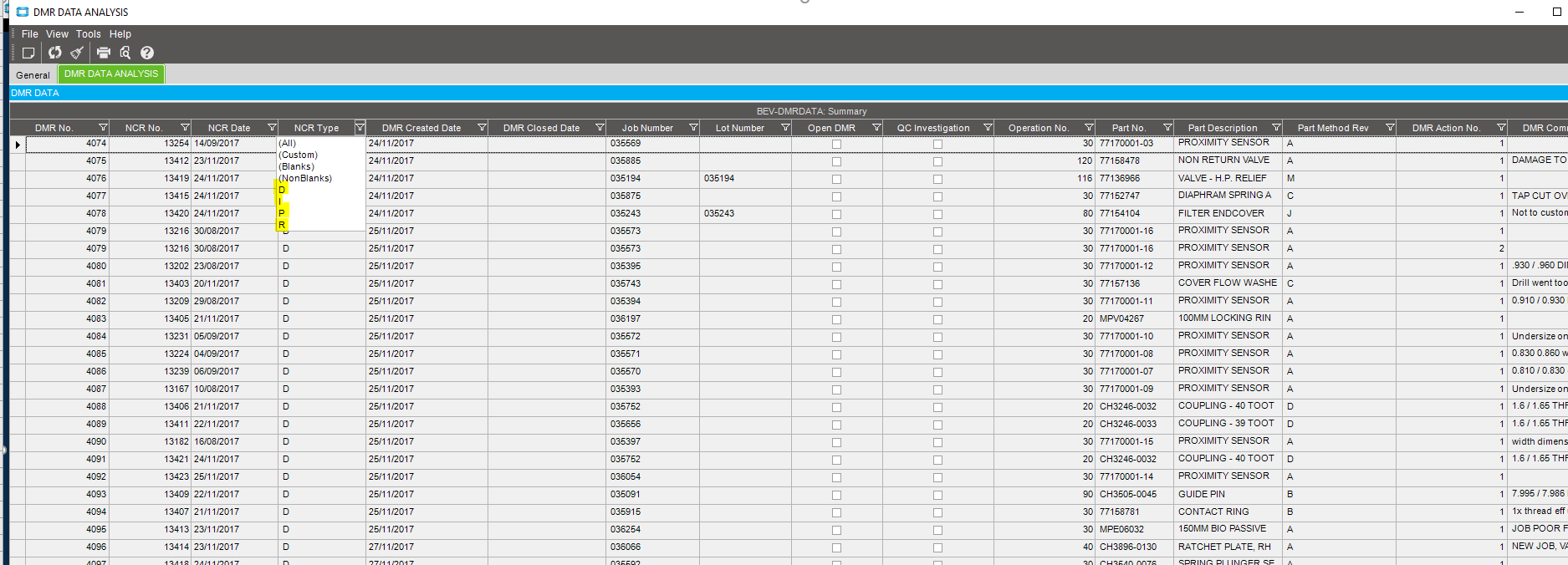

as @SDW there are two stages to deal with NCR, 1. once they moved to Inspection then 2.when failed Inspection and goes to DMR, at DMR you can accept or reject, and i suggest to use NCR type to identify NCR sources i.e. which ones is internal (operation[D]/stock[I] and which one is external (PO[P]/RMA[R]).
Hi Al.
TrnTyp is in the nonconformance table and identifies all sources of nonconformance.
yes i know, you can link the two tables and show this field, to identify each row so you can deal with it
