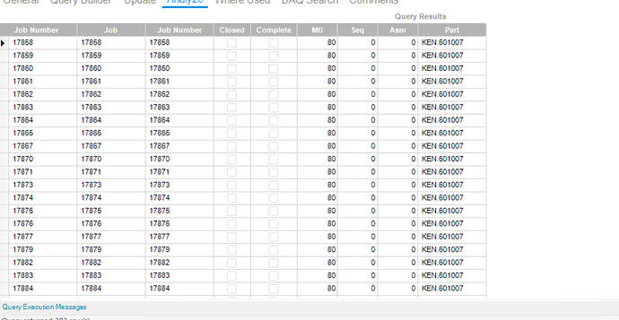

I got it to work in a UBAQ to an extent. It pulls down the jobs and I can go row by row and edit them.

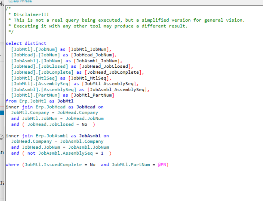

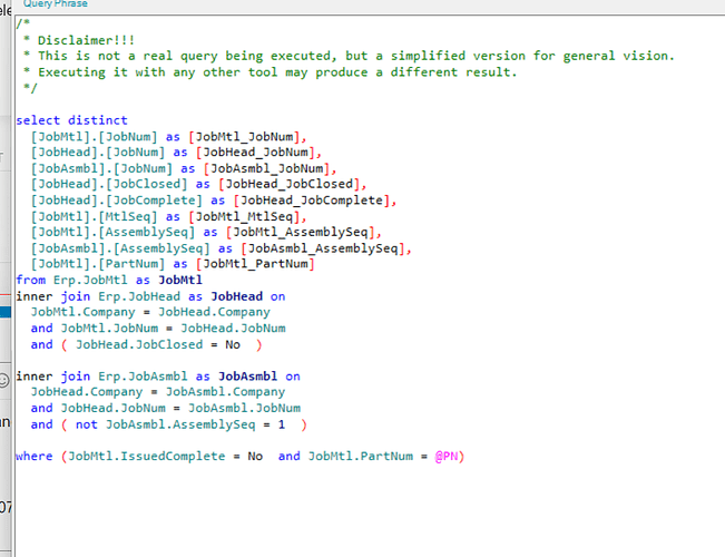

Here is what I got. Granted I don’t have the second parameter defined as of right now.
What I said won’t work with the basic UBAQ where you let Epicor pick the BO and stuff. You have make a custom BPM to do that. It depends on how automated you want to make it. The way you have it there will work fine, you just have to copy paste the part number over and over again.
