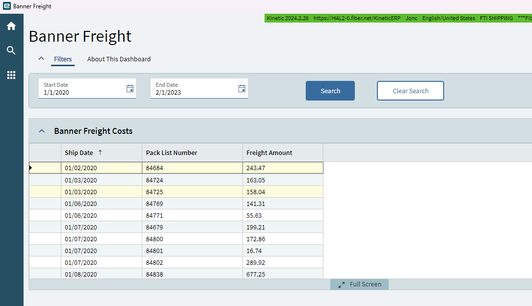

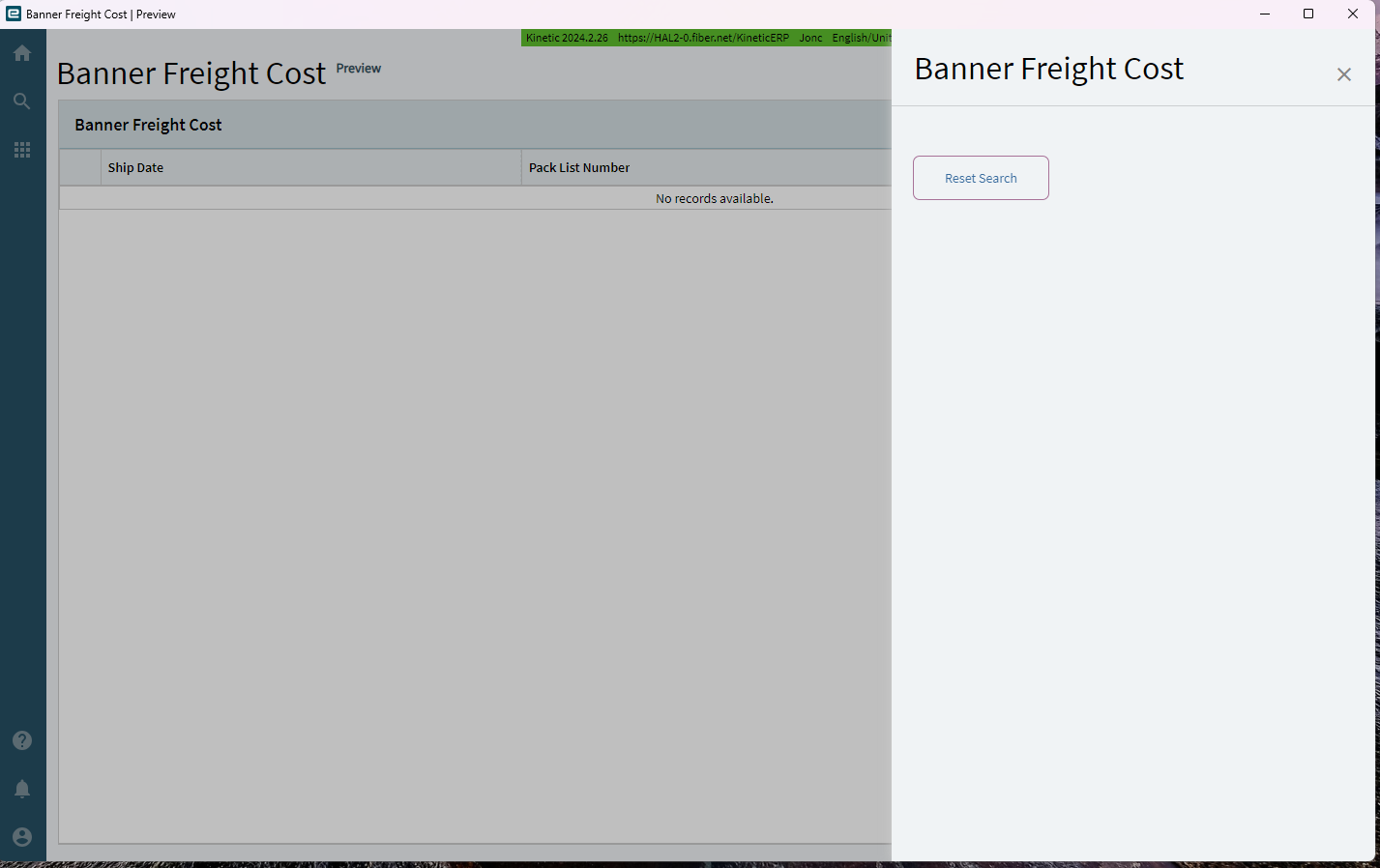

I’m trying to find a video or walk through on how to create a basic dashboard in Application studio that has a date filter on it, and I’m struggling with that. If I take an already designed Classic one that is a grid view on the bottom and a tracker view at the top with a date range setup, or just single date filter and I “preview” that as an application, the Tracker portion comes up as a slide out for the date, but even after entering a date if I close that window and refresh the grid display it ignores and actually clears out the date that was selected.
I want to duplicate something like this and I’m struggling. Granted I’m only able to work in 2024.2 right now since we don’t have a current cloud environment setup or the ability to run the latest 2025 on-prem version.
This is what that above dashboard turns into if you create the applcation from the classic Dashboard app. Not very helpful…
See this thread for some advice on dashboards: Taming the Dashboard Dragons of Application Studio - Kinetic ERP - Epicor User Help Forum

Holy Biscuits… @tpogue I’ve been working on the Dashboard Template instructions for about 2hrs… But so far on this simple dashboard I’ve been successful.
Lets gooooooooo! Nice work! Also, thank you @tpogue and @mbayley for sharing your tips and tricks for all of us on the forum. The magic of this forum is always amazing.
