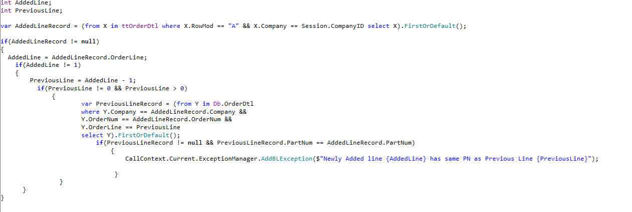

Try this:
This is at OrderDtl- Data Directive-In-Trans
int AddedLine;
int PreviousLine;
var AddedLineRecord = (from X in ttOrderDtl where X.RowMod == "A" && X.Company == Session.CompanyID select X).FirstOrDefault();
if(AddedLineRecord != null)
  AddedLine = AddedLineRecord.OrderLine;
    if(AddedLine != 1)
        PreviousLine = AddedLine - 1;
          if(PreviousLine != 0 && PreviousLine > 0)
                      var PreviousLineRecord = (from Y in Db.OrderDtl
                      where Y.Company == AddedLineRecord.Company &&
                      Y.OrderNum == AddedLineRecord.OrderNum &&
                      Y.OrderLine == PreviousLine
                      select Y).FirstOrDefault();
                          if(PreviousLineRecord != null && PreviousLineRecord.PartNum == AddedLineRecord.PartNum)
                              {                            CallContext.Current.ExceptionManager.AddBLException($"Newly Added line {AddedLine} has same PN as Previous Line {PreviousLine}");
Thanks …
