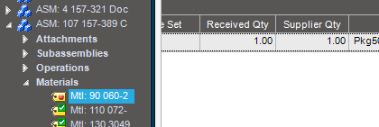

And how to fix? I can add the part back to the job, but it thinks it is unreceived even though it has been received.

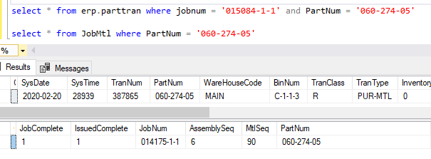

This is an extremely long shot, but there is a slight possibility that the material record wasn’t actually deleted, but that one or more of the pointers which connects it to the job tree became corrupted. In such an instance it might contain a bad job number or have a non-existent assembly sequence.
To test for this, write a BAQ to look for all job materials with the expected part number and see if you can identify any records which look out of place. You could narrow down your search to see if any of these contain the expected required date.
Yes that’s how I found the missing row.
The other job using the same part is correct.

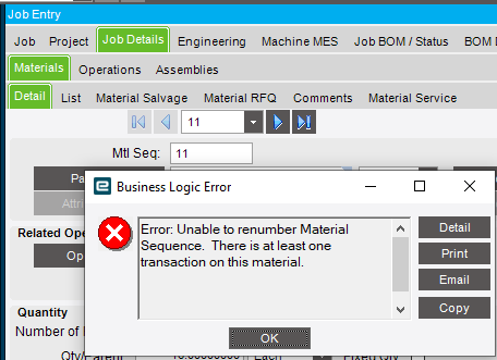

Oh I just figured out how to delete a JobMaterial Record with transactions against it!
You just need to change the material sequence number, it will let you change it. Then you can delete the material off the job! :grimacing:

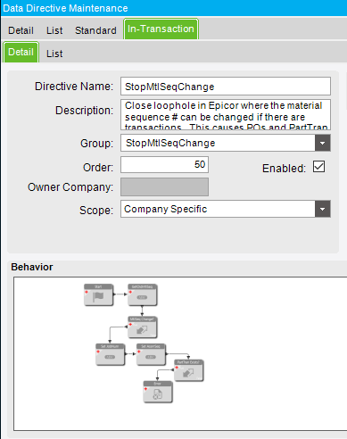

Here is BPM to close loophole where you’re able to delete JobMtl job materials that have transactions.
StopMtlSeqChanget.bpm (37.9 KB)
