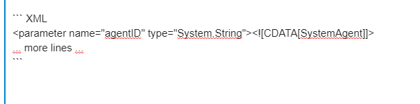

Did you trim the data out of your post? It might be missing because the open < and close > characters are trying to fromat your post as something else.
Try the following in your post. Add a line with three ticks and XML above the text you pasted. ``` XML And then just three ticks ``` after the pasted text. These have to be on there own lines. Your post shpould look like:
This will make post format like:
Not sure what I did wrong but the ticks didn’t work for me. However, I did put the text in as preformatted text. It’s not pretty but all of the information is there from that part of the log file.
The “ticks” are on the key with the tilde (~). Next to the 1 key.
OK - thanks for the clarification. Here is the part of the log. This is the only instance of CallContext in the log file.
