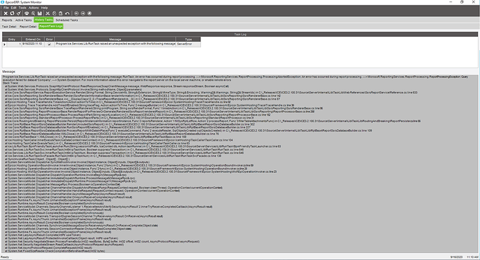

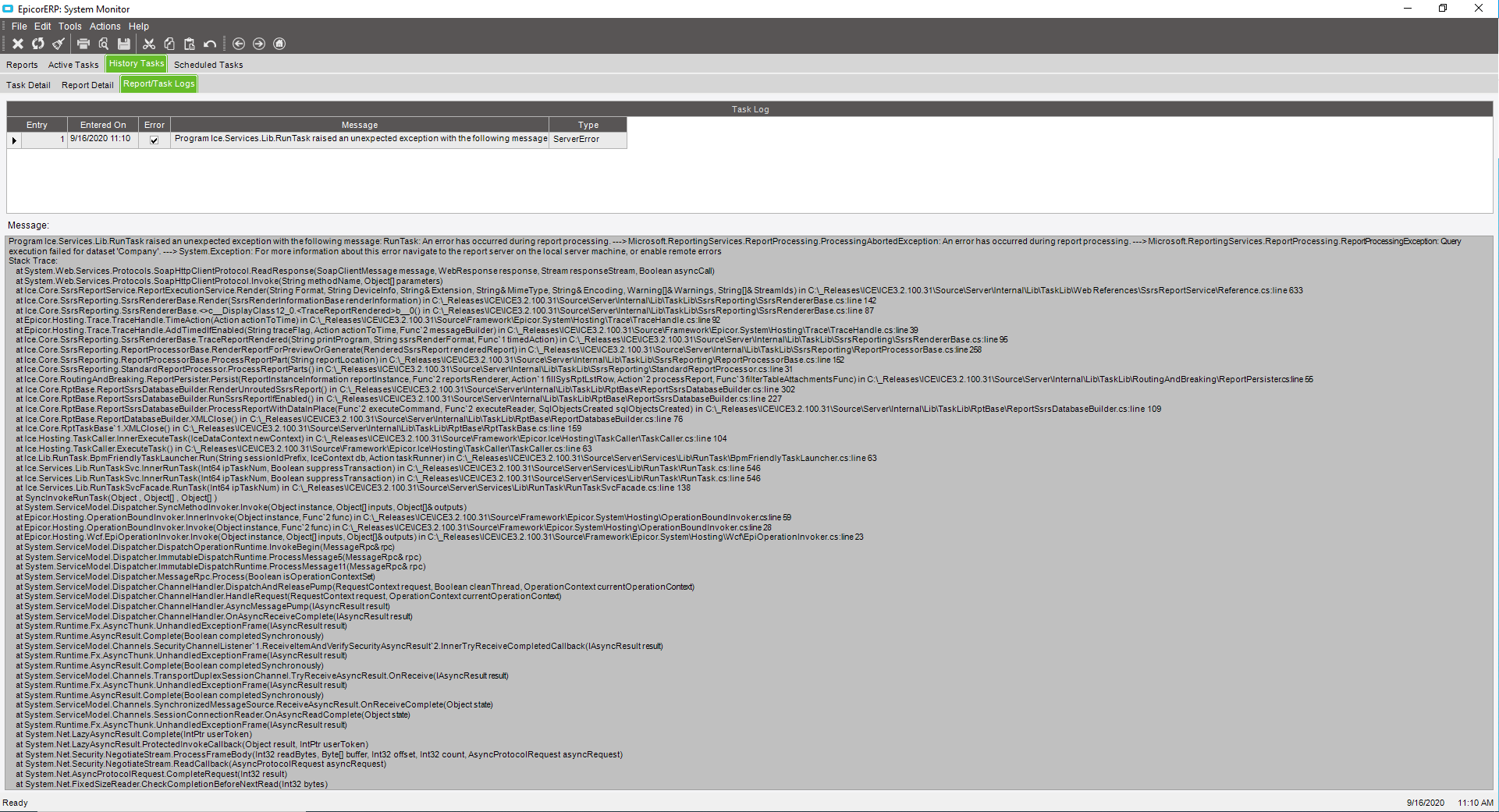

When I run the report from a menu item, the Report Options display the AsOfDate but I get the following error:
The report server shows the following error:
processing!ReportServer_0-76!a34!09/16/2020-11:10:05:: e ERROR: An exception has occurred in data set ‘BAQReportResult’. Details: Microsoft.ReportingServices.ReportProcessing.ReportProcessingException: Query execution failed for dataset ‘BAQReportResult’. —> System.Data.SqlClient.SqlException: Invalid object name ‘dbo.BAQReportResult_79aee6cd65f34a3ba36f6ba3ba5b6930’.
processing!ReportServer_0-76!1750!09/16/2020-11:10:05:: e ERROR: Throwing Microsoft.ReportingServices.ReportProcessing.ProcessingAbortedException: [AbnormalTermination:ReportProcessing], Microsoft.ReportingServices.ReportProcessing.ProcessingAbortedException: An error has occurred during report processing. —> Microsoft.ReportingServices.ReportProcessing.ReportProcessingException: Query execution failed for dataset ‘Company’. —> System.Data.SqlClient.SqlException: Invalid object name ‘Company_79aee6cd65f34a3ba36f6ba3ba5b6930’.

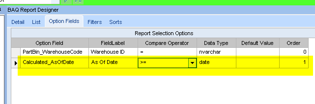

Thank you Calvin - I tried that but I need to use the AsOfDate parameter in calculated columns and those calculations did not get the AsOfDate when I did that. I was able to get the Options field to work for filters in the baq but not in calculated columns. Is there a way for me to access that options field value in the ssrs report? Then I can just do the calculations there.

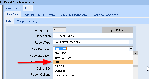

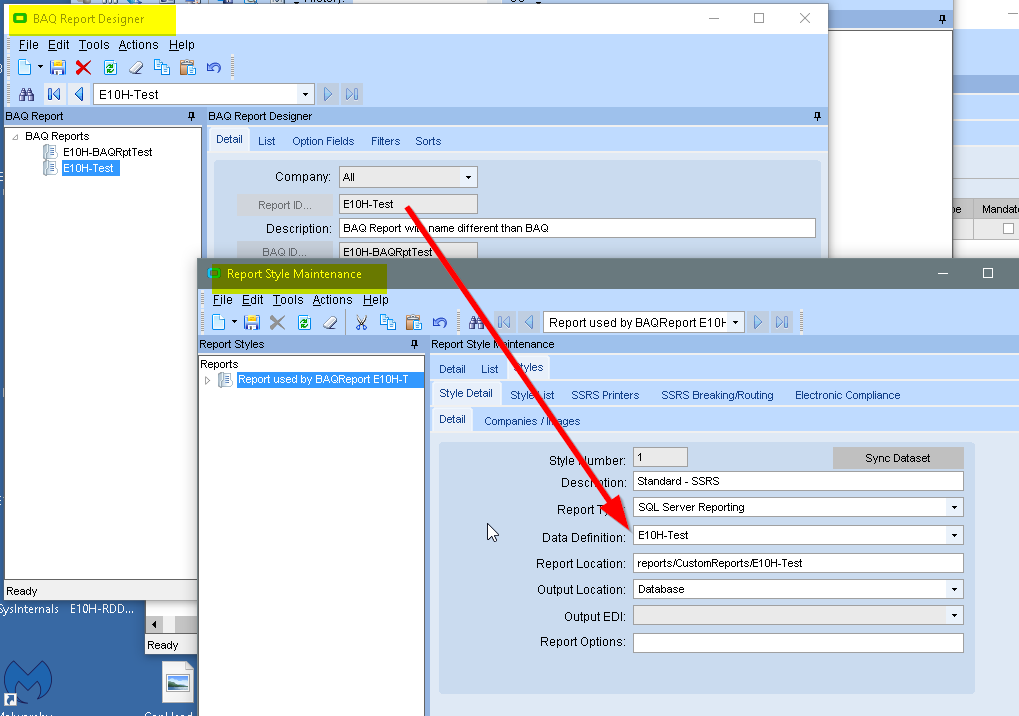

If you made the BAQ Report first, there’s a chance there’s a conflict in the Report Style’s Data Definition.
When you make a BAQ Report, that BAQReport ID becomes both the ReportID AND the Data Definition used in Report Style
A “blank” RDD will be created using that ReportID (E10H-Test in my example). I can add the BAQ and criteria sets and everything.
But back in Report Style, the Data Definition field dropdown only lists one entry for E10H-Test. Is that for the BAQ Reprot or the RDD?
That’s a good question since I’ve named both of them the same. Could that be adding to the confusion? Which one would I want it to be?

  • adding ReportParam_Date01 as an option field in BAQ Report Designer
