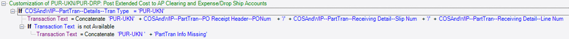

@Daniel_White KB0106222 is a good example to follow. The nice thing about custom posting rules is that the original rule is executed first and then the custom, so you only have to have the fields you are changing. Also the edited rule shows with a symbol so you can tell which ones have a custom section. I followed this KB and made this rule for PUR-UNK
Would this work?
@Daniel_White That should. Assuming you are developing this in a Test or Pilot system you can check the manually review all transactions and look at the results in the review journal if you run a capture.

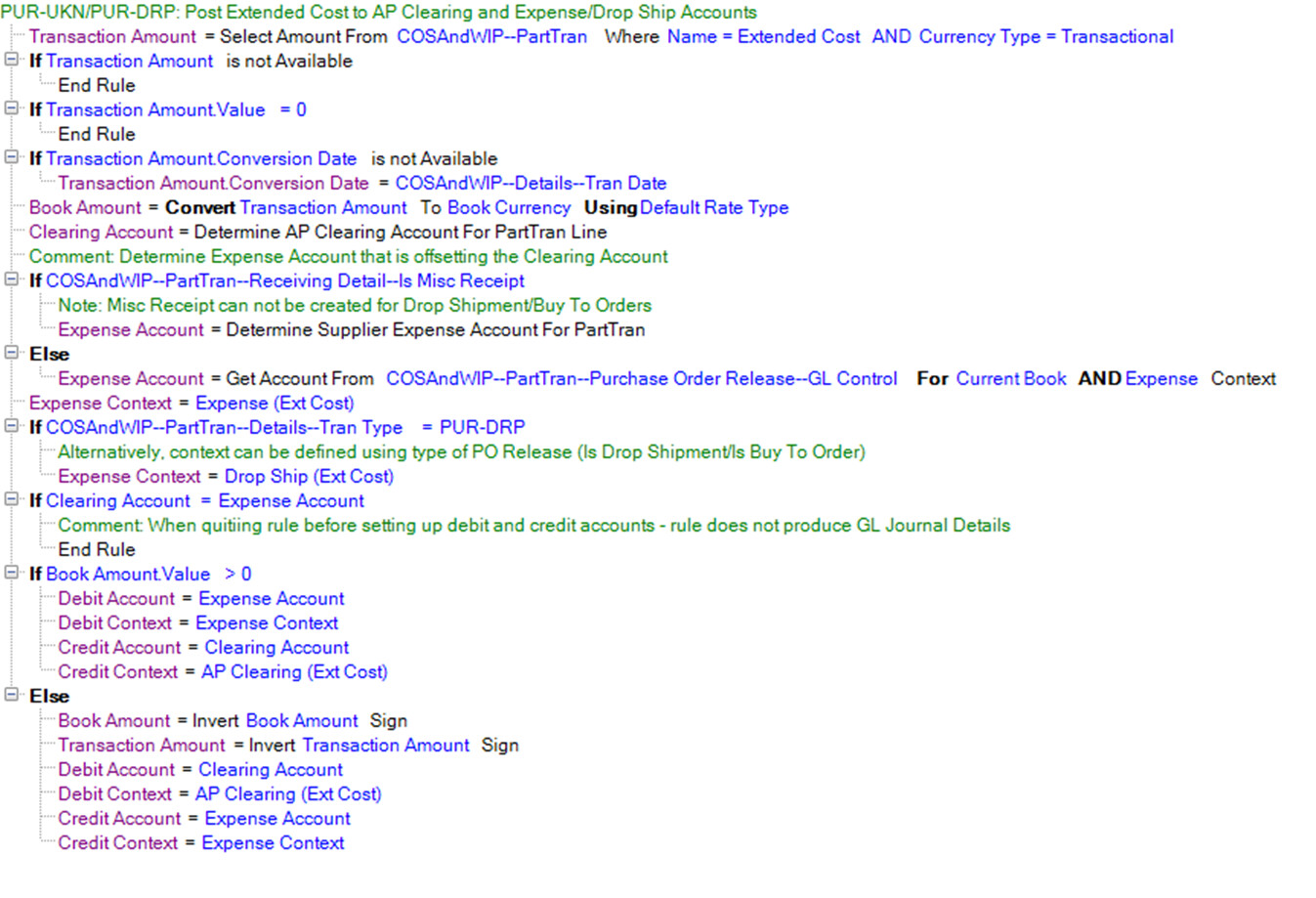

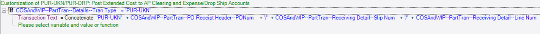

What i developed worked, so much of a relief to our Finance Team moving forward! What they asked was could i put it in our current E9 environment? I noticed that it does not have a customisation tab in E9, any idea where to insert it in the below?

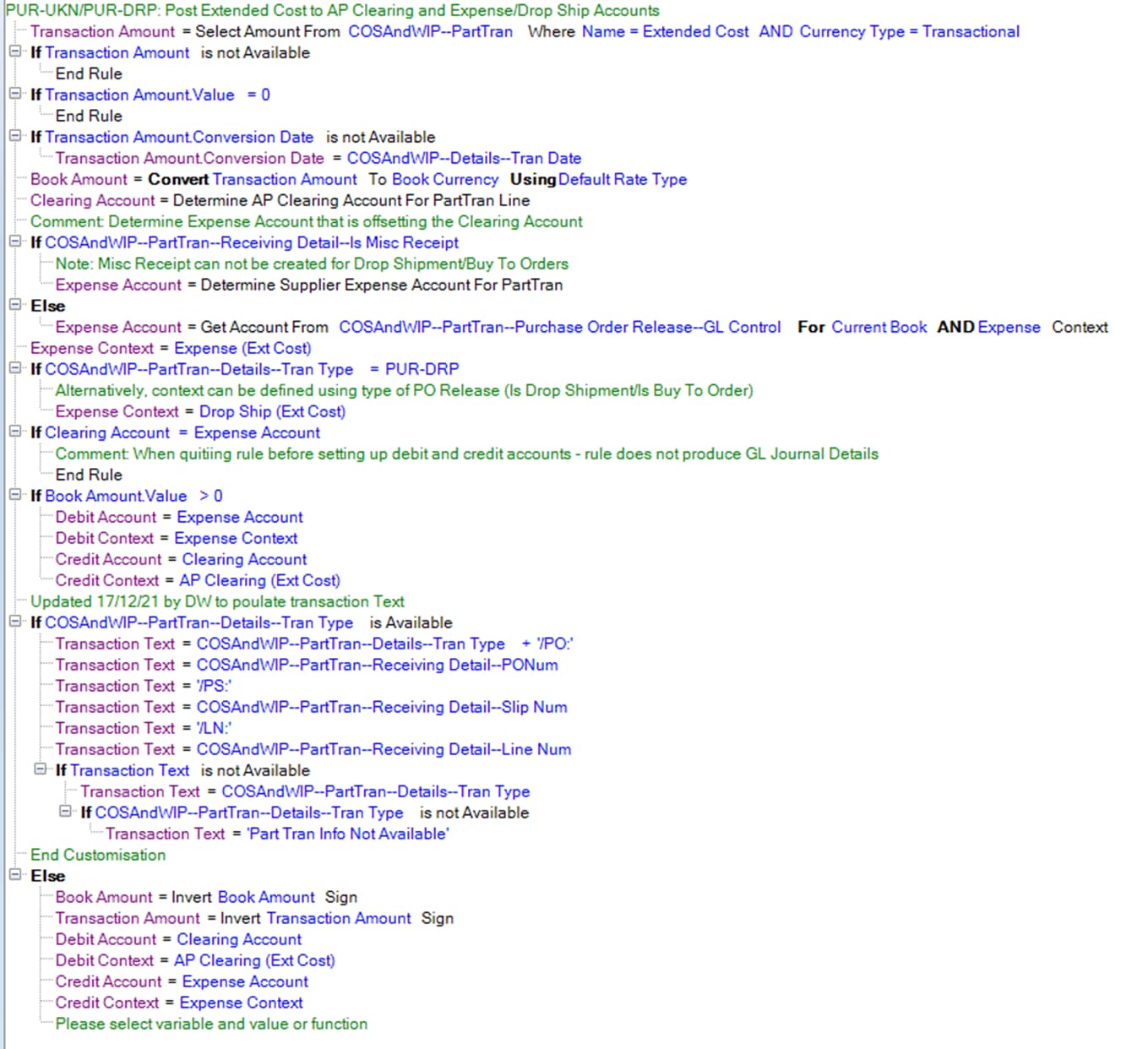

Is what i used in the end.
For the life of me i cannot get to work in E9. All i get is the Pack Slip Line Number in the Review Journal.
@Daniel_White Sorry I didn’t get a notice on this, but we did not do this in E9, so I don’t know what is missing. It is probably a function that is new since then.
Hi @gpayne after a little prompting from @hkeric.wci i realised what i had done wrong in a previous attempt at trying this using a Customised Function calling ‘Result’. In each line of the Transaction Text for the Function i was not calling the previous lines Result which is why i was just ending up with the Pack Slip Line as the result :laughing:
