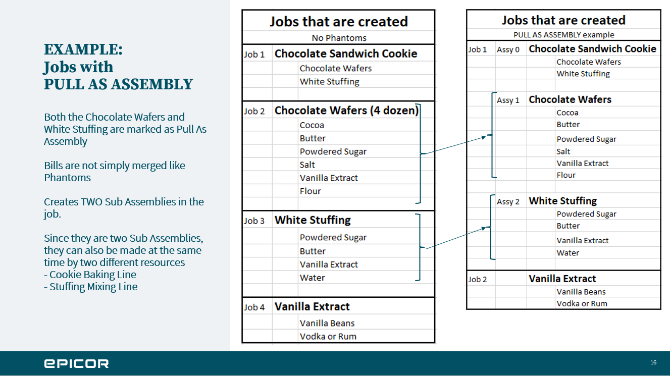

Epicor Kinetic supports a different concept called “Pull As Assembly” that DOES keep the parent part number. if you mark the items as Pull As Assembly instead of phantom, then you will see each part, and its BOM in the job.
I have seen this tactic used when companies wanted to show the assembly as distinct for each thing. They put one operation “Issue material” on each BOM so that the materials in each sub assembly is issued.

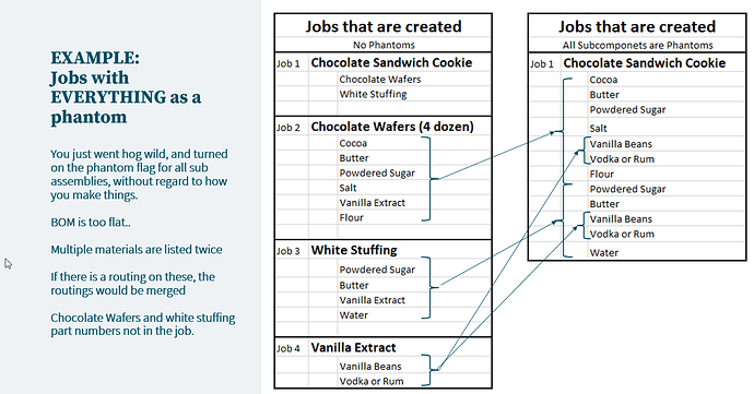

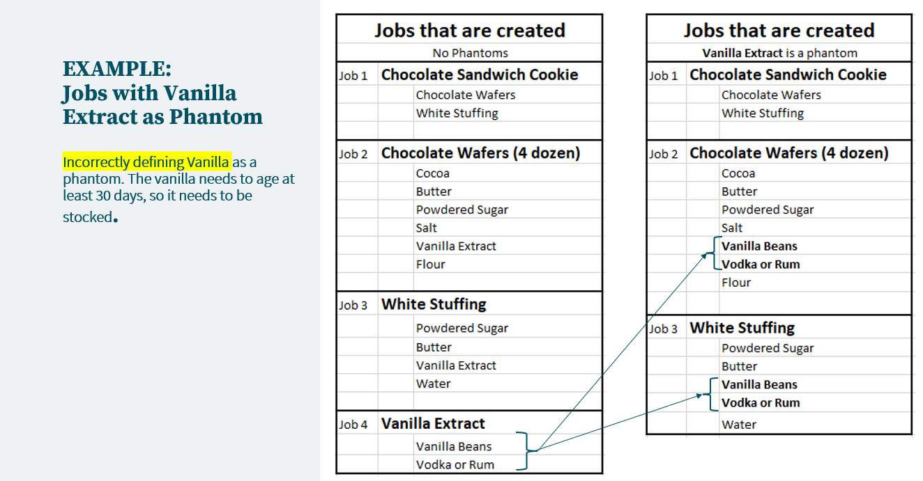

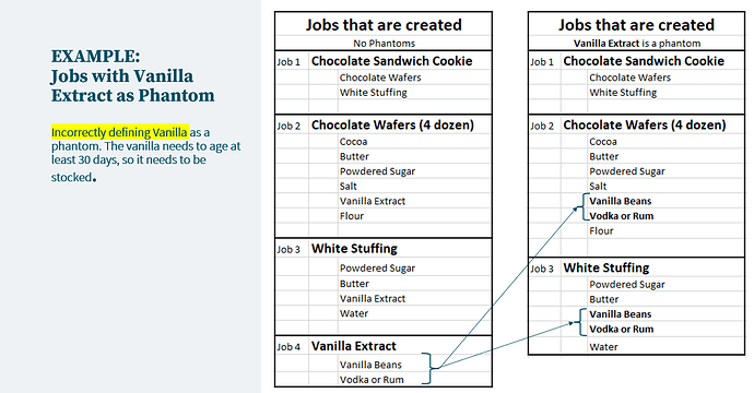

Here are some slides i created for a user group presentation on phantoms:
