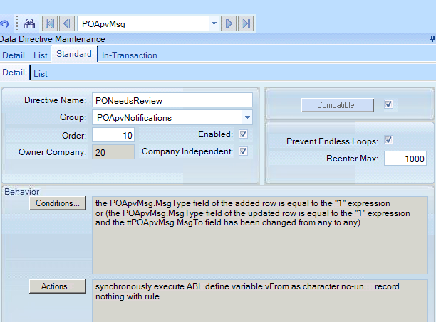

Here are the two data directives, as E9 examples, one for an email that a PO Needs to be Reviewed going to the Approver and another one for an email back to the Buyer after an action has been taken. You don’t have to use ABL code for the action and instead use a few different actions and the email action

define variable vFrom as character no-undo initial "".
define variable vTo as character no-undo initial "".
define variable vCC as character no-undo initial ''.
define variable vSubject as character no-undo initial ''.
define variable vBody as character no-undo initial ''.
define variable hEmailEx as handle no-undo.
for each ttPOApvMsg where ttPOApvMsg.RowMod = "A" or ttPOApvMsg.RowMod = "U":
	for each PurAgent where PurAgent.Company = ttPOApvMsg.Company
											and PurAgent.BuyerID = ttPOApvMsg.MsgTo
			no-lock:
		assign vTo = PurAgent.EMailAddress.
	end.
											and PurAgent.BuyerID = ttPOApvMsg.MsgFrom
			no-lock:
		assign vFrom = PurAgent.EMailAddress.
	end.
  assign vSubject = "PO " + string(ttPOApvMsg.PONum) + " has been " + ttPOApvMsg.ApproverResponse .
  assign vBody =
		"Company: " + ttPOApvMsg.Company + chr(13) +
		"From: " + ttPOApvMsg.MsgFrom + chr(13) +
		"Response: " + ttPOApvMsg.ApproverResponse + chr(13) +
		"Comments (if any): " + ttPOApvMsg.MsgText + chr(13) + chr(13) + chr(13) + chr(13) + "DD.POApvMsg.Std.20".
  run Bpm/BpmEmail.p persistent set hEmailEx.
  run SendEmail in hEmailEx (false, CUR-COMP, vFrom, vTo, vCC, vSubject, vBody, '':U).
  if valid-handle(hEmailEx) then delete procedure hEmailEx.
end.

In the E10 help they finally added wording explaining that there is not ANY AUTOMATIC emailing and all require a BPM. The nice thing is that in most places there is a nice table like POApvMsg to put a Data Directive on to easily trigger it and get all the content that would have been in an email message.

My understanding was that this was for E9, so what I posted here is for E9 and this would be ABL.
In E10 there are data fields for BPMData such as Shortchar01, etc, however in E10 I accomplished this completely differently since there are more widget options in Data Directives in E10. You can create all the variables you want and the BPMData fields do not need to be used. The other post is an example for E10.
Also, different people have different ways of writing BPMs. My preference is to use as much of the provided BPM widgets/actions as possible and write as little ABL/C# as possible. I believe this makes it easier to maintain and during upgrades I think there is a better chance of conversion tools converting properly as opposed to custom code.
