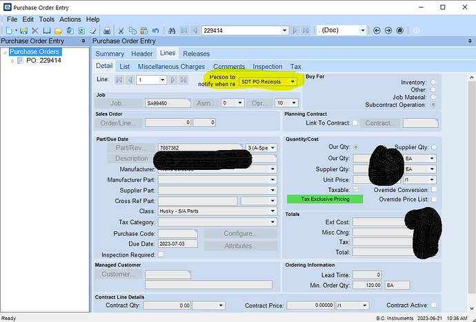

Question on this before I start attempting to not screw this up… We are slowly upgrading to Kinetic and we have a customization in PO Entry on the Line Details. Basically, within the customization, when selected, there is a list of people to email when certain lines are received. If we don’t need it, the space is left blank.
How would I even begin to start with this for Kinetic as the customization is only working in Classic?
