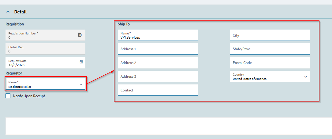

I am trying to customize the Requisition Entry form with something that feels simple, but has been causing me a lot of trouble. I am pretty new to Kinetic/Epicor so I am still figuring out how to get data around.
What I am trying to do is when a Requestor is selected from the drop down, the user’s address populates. I know it is pulling data from the UserID table for the dropdown somehow but unsure how I can bring additional data over here. Would I have to remove the standard address fields and created UD fields and EP.bind those to the UserID table? I have it working as a BAQ where the userID is linked to the RequestorID and that works fine, shows the address, requisition ID, requestor, everything correctly, but unsure how to mimic that effect in the form.
Currently, what it seems to do, is automatically select me as the Requestor because I am signed in as me, but we’d like the option to request things on behalf of someone else, and if that person has a different address, we’d like that to be pulled from their account details.

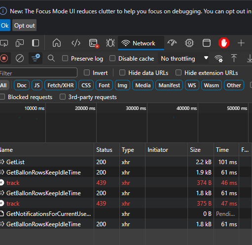

When I do a browser dev tracking (Network tab after hitting F12), when I click the dropdown it calls GetList and when I select a different name, it doesn’t show anything

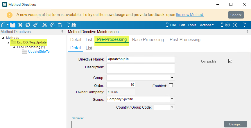

    Write a Pre-Processing BPM on Erp.BO.Req.Update with a condition to check if the value of RequisitionID is changed from any to any then use LINQ or BAQ to get the ship to address from the Users table and update the relevant fields in the dataset. The only downside of this approach is that users won’t see the updated address until they click the save button.

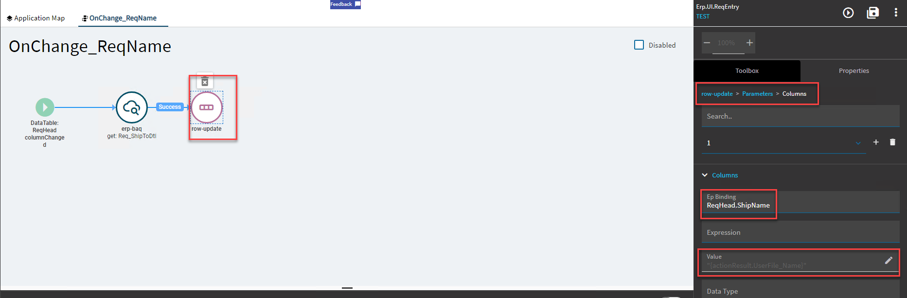

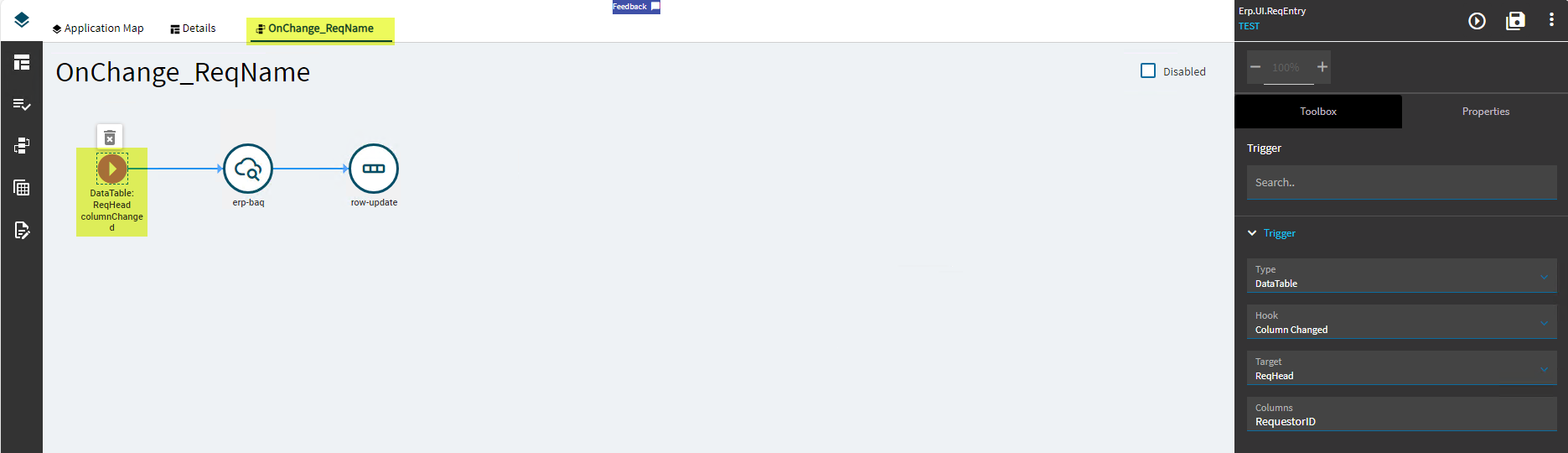

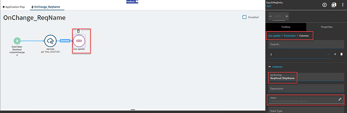

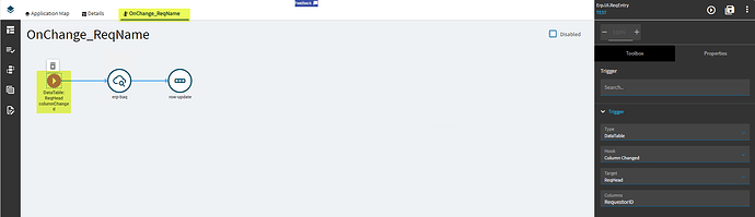

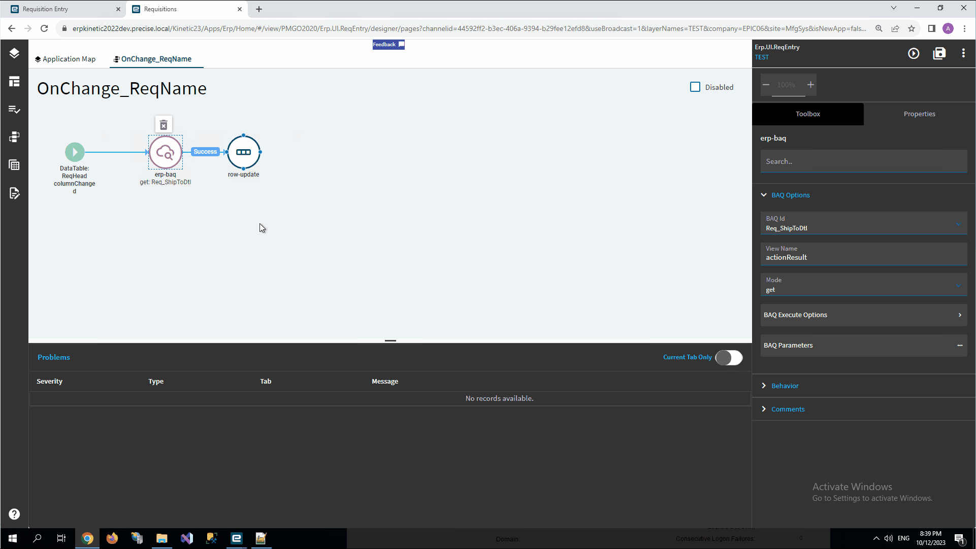

  1. Approach 2 (Kinetic UX customization): Create a new custom layer on the Requisition app and a custom OnChange event on the Requisition ID. Please see the screenshot attached with the properties you would need to set. Once you have that, just call the BAQ (using Erp-BAQ widget) or a UserSvc (using REST widget) whichever you prefer (I would go with BAQ) and pass the requisition ID in where clause to grab the information and use row-update to update the ship to address values.

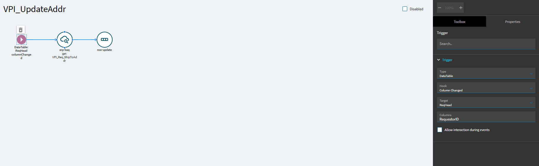

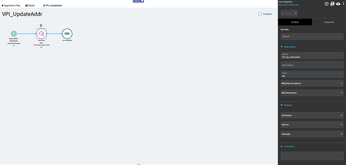

Hi Mateen,

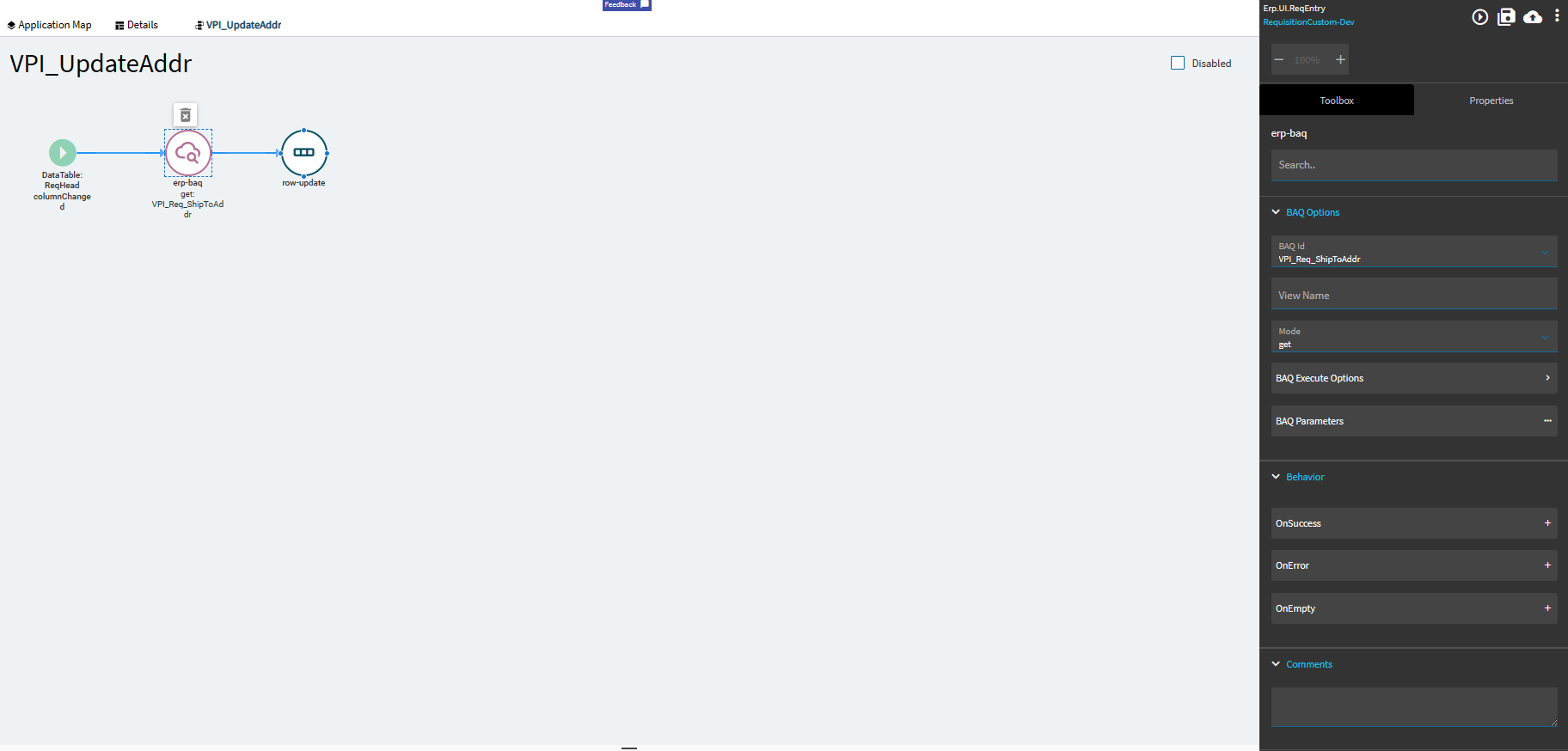

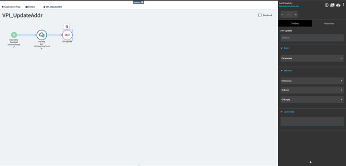

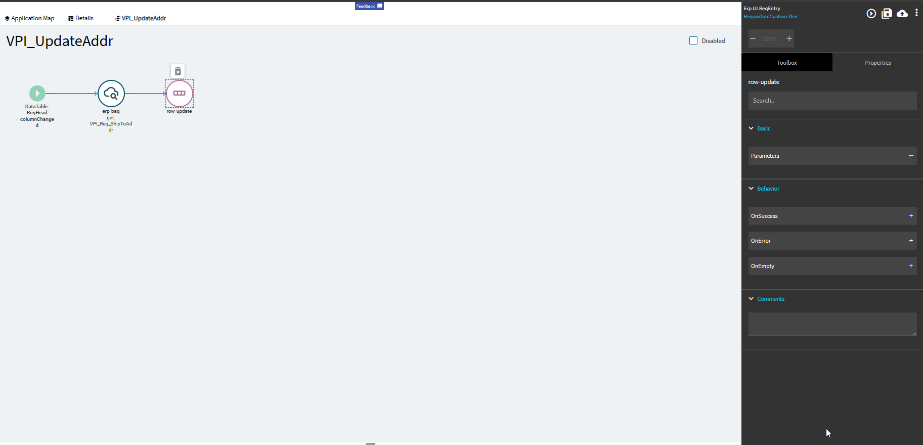

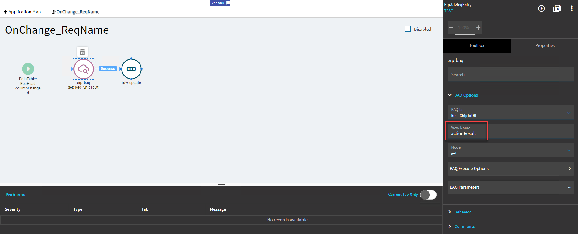

I just tried setting up this and not sure what to put in the row-update or if there is anything else in erp-baq tools. I related the User and Req tables with the UserID and the addresses populate in the BAQ correctly, when I set the Display field as the ReqHead address fields, meaning they populate with the user’s address. I have attached screenshots.
Hey Mack
You would need to create your custom view and assign it to the erp-baq widget or use the actionResult. Secondly, with row-update, you need to update the values by copying the values from the actionResult view to the ReqHead view. Please see the screenshots attached.
ReqShipToAddress
Hi Mateen,

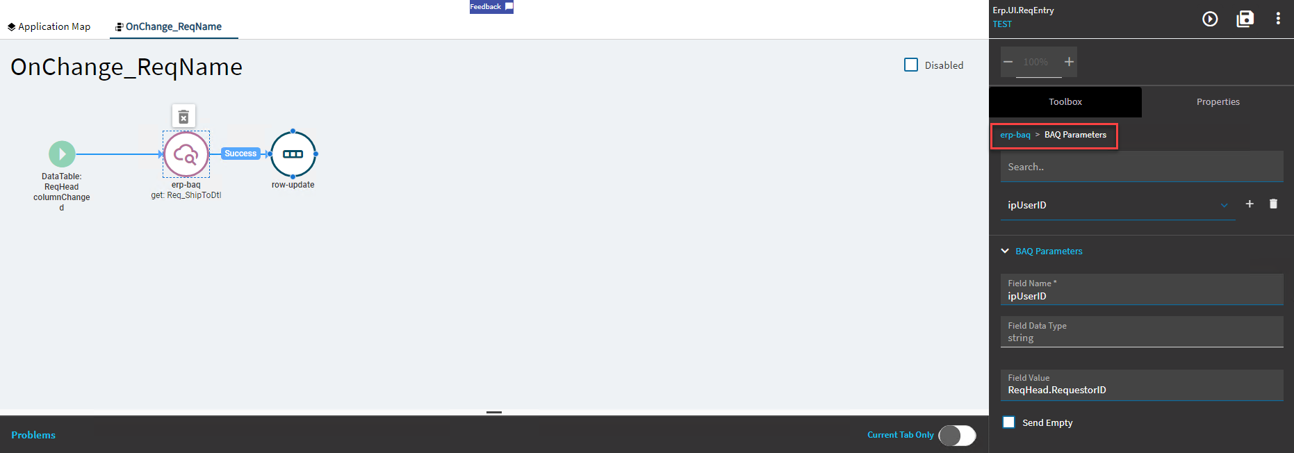

This was exactly what I need, I was able to get it working after adding a parameter to the BAQ and mapping that. I have never done that, so this has been very informative. Thank you for all the work you put into this.
