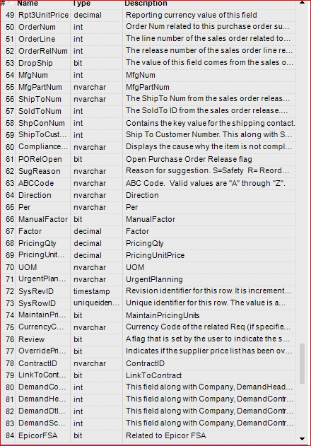

Issue is I don’t have this date in SugPoDtl table. All I see is Order by date and due date.
In my table, it is field #87, the last field in the table.
Since we haven’t run PO suggestions yet, we don’t have any data in our table to compare to so I can’t show you the exact setup.
Last field I have is #84
Am I missing on anything?
Probably a version thing, that field doesn’t exist in 10.2.400 either.
