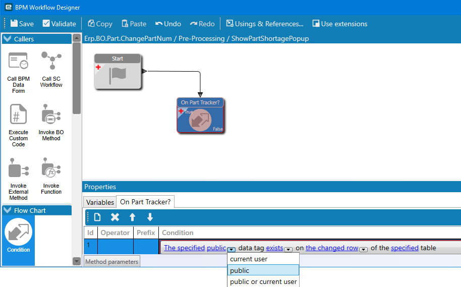

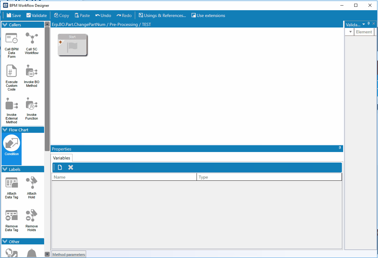

Thanks but in the Workflow Designer, I don’t have that option listed for the Condition properties…

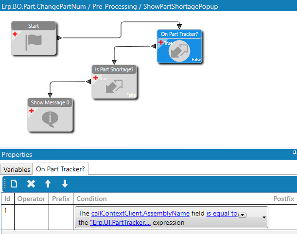

… shouldn’t I see something like this?
I’m pretty sure it’s the assemblyName. put that in a messagebox and see what pops up.
Yeah you should see stuff in screen #2 do you have advanced BPMs enabled?

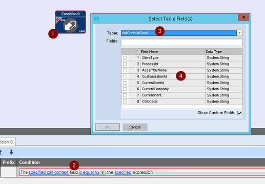

There’s a crappy interface in that screen now, you have to click all the way to the Right next to the Arrow Explicitly .
Try this

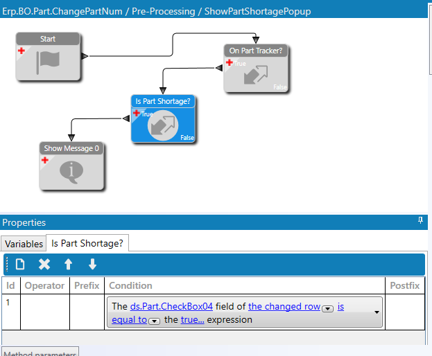

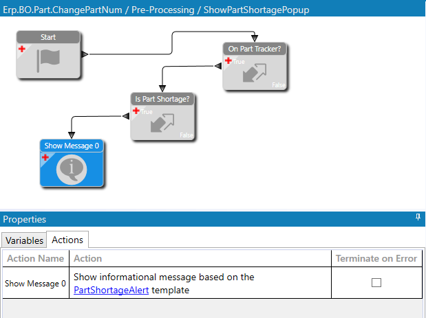

Ok, thanks. I found the Context. I have the BPM flow fleshed out but I must be missing something. Any tips?
I’ve got a Method Directive firing on Erp.BO.Part.ChangePartNum as a Pre-Processing entry.
Not sure if the Part Tracker fires that event, but I don’t have any documentation so let me know if that’s incorrect.
Then, the flow shown below. I thought this was going to be super easy… :hushed: … but, alas. I must have an incorrect binding somewhere.

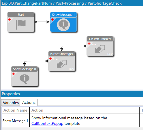

So I changed it to Post-Processing but there’s nothing firing.
To test, I changed the workflow to only show a popup:
so that I could see if the Assembly was correct. The popup contents display: Assembly is: <callContextClient.AssemblyName/>
… but nothing is happening on Part Tracker after entering a part.
Perhaps the Erp.BO.Part.ChangePartNum is not the correct one to bind to in Part Tracker and that’s why there’s no activity?
Did you do a trace? my guess is you want GetByID instead.
I did a trace, and you’re correct – it was GetByID.
BTW, the AsseblyName from the CC is the DLL name w/o the .dll extension.
