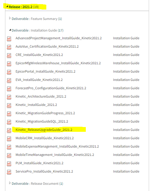

In my upgrade guide it is in post installation 3.1.10 and 3.1.11

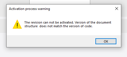

I did the import again and now if shows that it’s a “Draft”. I try to make it active and I get this error. Which makes sense I think. We jumped from 10.2.300 to 2021.2 so I imagine there are lots of examples where there are changes.

in EpicWeb under the base of the revision you are going to.
So, you want to do Import. Then on the import screen, select Standard and All and click on Load Transaction Type.
Select Import All, Update Mode All, Replace All, and Change All Revision Status to Active.
Then click Process.
I did say this was my first time… I’ve skimmed through the documentation before but I never took notice there was an upgrade guide. Now I know. Thanks!
