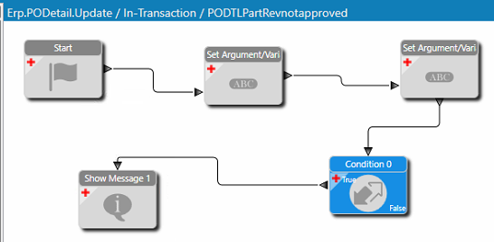

@Jennifer You need to give the query the part and rev to lookup.

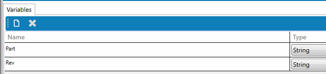

First assign Part and Rev to variables with Set Argument/Variable

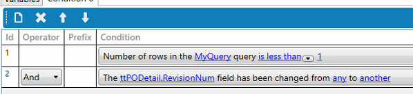

You don’t want to check on every update. Only when the Rev changes so add another condition.

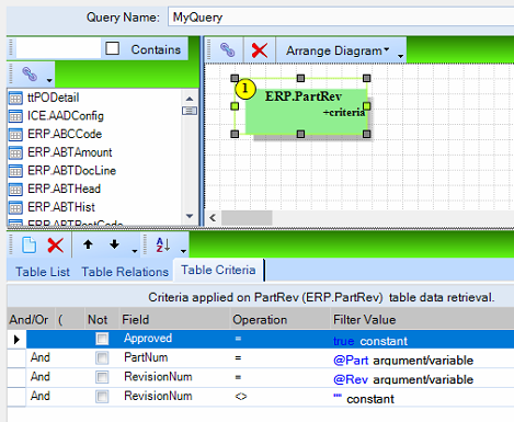

You could join to the ttPODetail, but that is bad, so we will use the variables Part and Rev to find if the Revision is approved. I also added that Rev was not blank. Not sure if it is needed.

In Greg’s screenshot he has Approved = true, you want Approved = false I think. Is it currently NOT firing when it should (i.e. the reverse of your desired behaviour)?

I would move to using a Method Directive on the PO.Update method. Use pre-processing, then you have the choice of either a warning or a block.
Use the same template that Greg provided, make sure to use “Set Field/Variable” block once for each variable. I confused you in my previous reply, I spotted that Greg used a check for query rows less than 1 so his TRUE would work.

@Jennifer The way I posted looks for the rev to be approved and sets the warning if the revision is not approved and MyQuery returns 0. That is why number of rows is less than 1. What is your version you just have E10. I have a 10.2.400 and can send you a working version if you are 10.2.400 or better.
