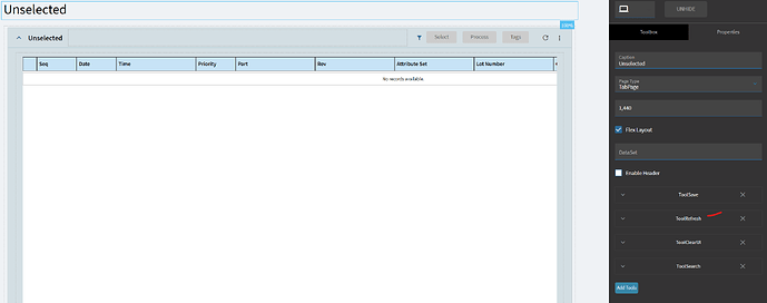

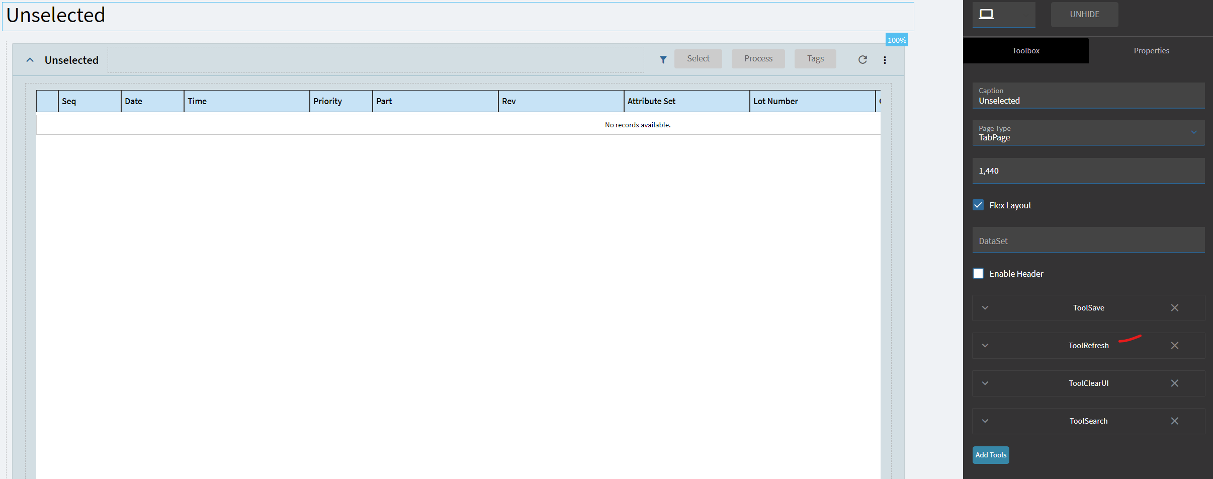

App studio query about promoting the Refresh tool to the Primary Toolbar. If the tool you want to promote is visible in Action Data, you can just tick the nice little box that says “Add to Primary”. BUT, the refresh tool doesn’t appear in that list. I guess the refresh tool is part of the framework of the grid, rather than a tool that’s been added to it.
Anybody had any success in being able to promote this button to sit alongside the others?

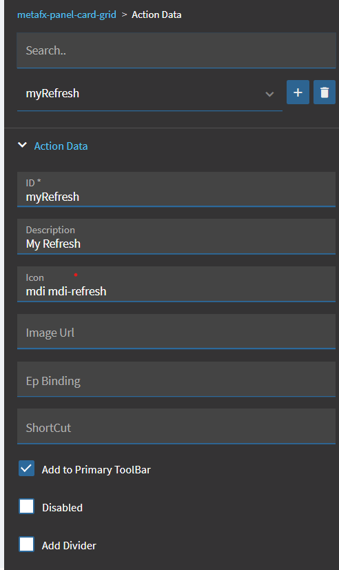

Yeah its a tad odd but the primary is in the page container itself for the refresh.

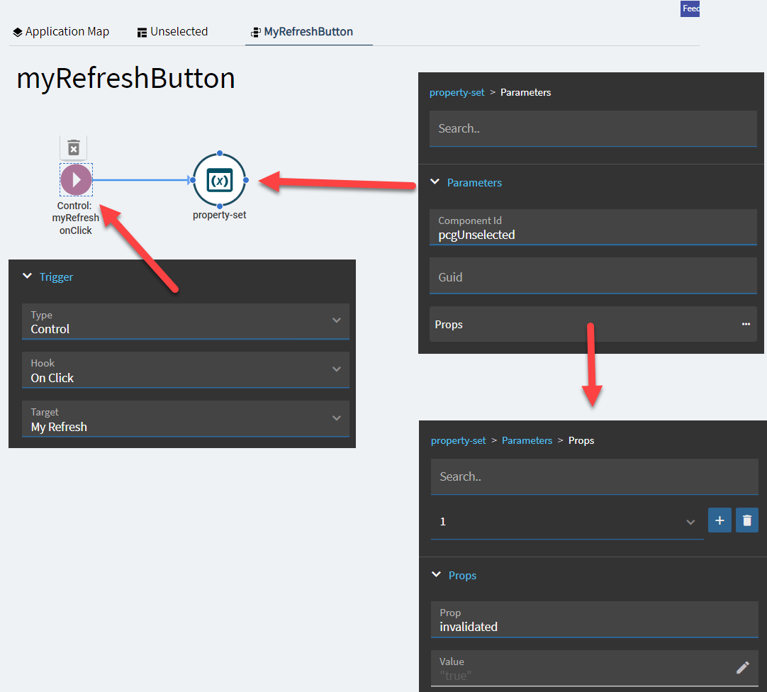

To get the refresh button added to the panel add your own action data.
Thereafter its just a matter of hooking up a on click event to your button and invalidating the grid panel.

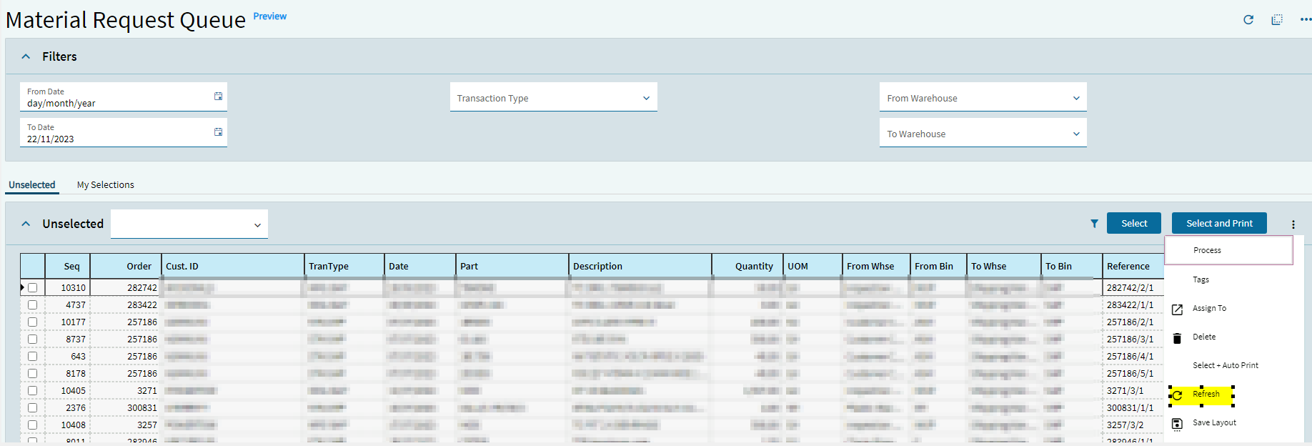

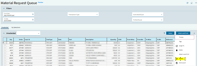

Small correction here: the refresh you’re referring to is the page refresh, not the grid’s refresh.
What’s going on here is that when you use the provider model to retrieve the data for your grid, it automatically adds the refresh to the panel’s overflow menu. You can’t do anything about this. :upside_down_face:
The rest of your post is spot on for how to “workaround” it, though. The only downside, though small in my mind, is you’ll have two refresh buttons on the panel that essentially do the same thing. #Shrug

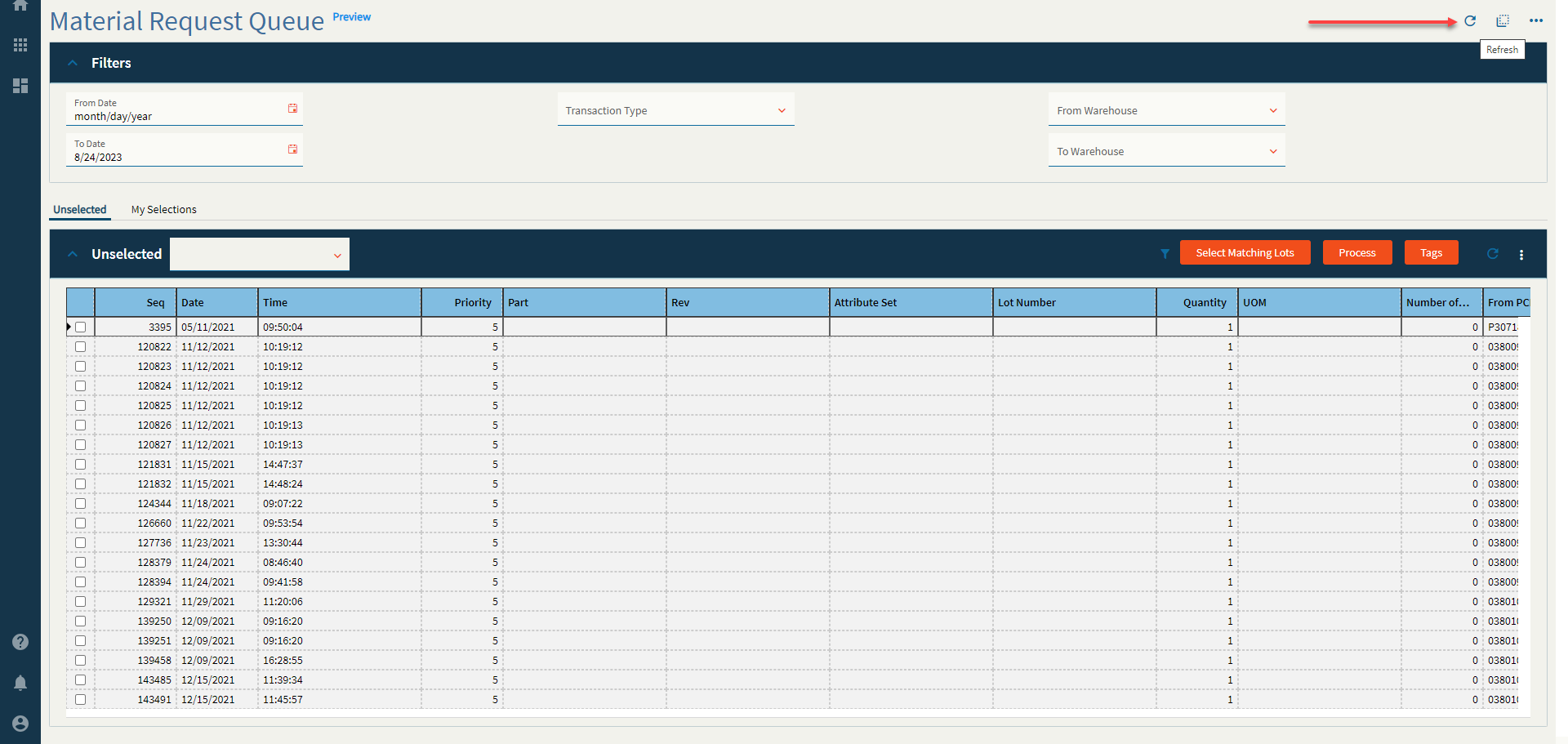

Thanks @hmwillett :slight_smile: - Maybe I should have changed the terminology I used.
That refresh I was referring to was part of the action data of the “Tab page”.
Right. Each page has a header like that and the action data refresh will refresh the entire page instead of just the grid.

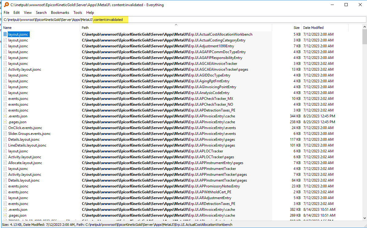

“Everything” by VoidTools is your friend.

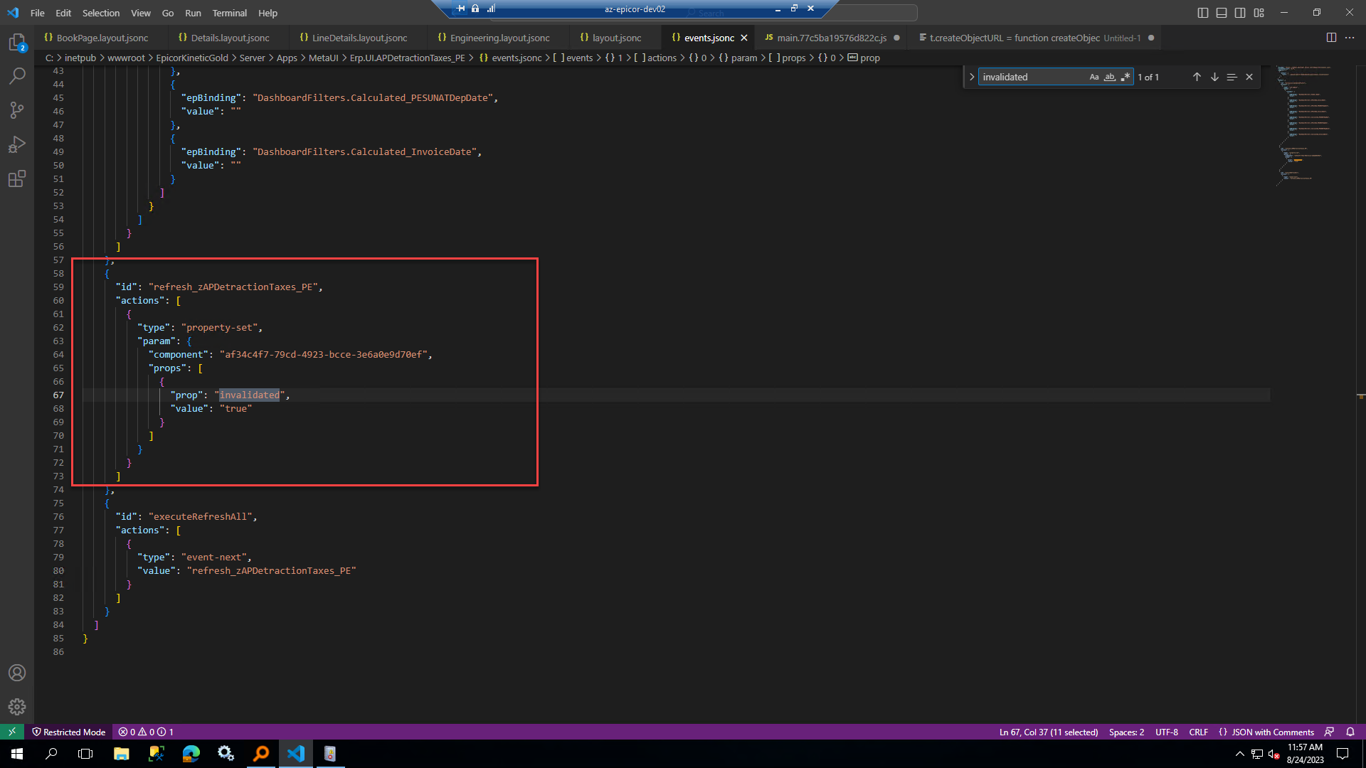

This is my reverse engineering approach. Find what you’re looking for in Epicor’s native JSON files.
Example file:

OMG I love the Everything product. Been using it for years, blisteringly fast compared to Windows search!
Thanks for the advice on checking the base files :+1:.

I did this and I could not get it to function for a single grid. What is the purpose of the “invalidated” prop parameter? Once I get this to work I will then need it to function for multiple grids on a single tabpage in app studio. So if there is any knowledge on that, I would love to hear about it.
