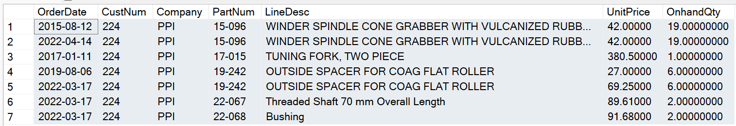

Hey guys I’m having some trouble narrowing down my query results in SQL. My goal is look at the parts currently in inventory and pull the last most recent order for any customer that was made for any of the parts in inventory. My current problem is that if the price or the line description is different then I end up pulling more than the most recent order (older orders for the same part at different prices, or with different descriptions). Is there any way to make sql only pull the last order but still have the description and price that I need to show? Below is the Query and the results below.

Results
Here’s what I added to make it work:
select top(1) with ties
Max(a.OrderDate) as OrderDate,
Max(a.OrderNum) as OrderNum,
a.CustNum,
a.Company,
b.PartNum,
b.LineDesc,
b.UnitPrice,
c.OnhandQty
from erp.OrderHed a
left outer join erp.OrderDtl b
on a.Company = b.Company
and a.OrderNum = b.OrderNum
inner join erp.PartBin c
on b.Company =c.Company
and b.PartNum = c.PartNum
left outer join erp.Customer d
on a.Company = d.Company
and a.CustNum = d.CustNum
where a.Company = ‘XXX’ and b.UnitPrice > ‘0’ and b.partnum = ‘PART’
group by a.CustNum,b.PartNum,b.LineDesc,a.Company,b.UnitPrice,c.OnhandQty, a.orderdate
order by row_number() over(partition by a.custnum order by a.orderdate desc);
I was able to return the top/most recent row for each customer by part.

@TinaK I was able to take your script and modify the over condition to make it work by part. Looks like its working now. thanks for the help. Any chance you could explain what the " order by row_number() over(partition by b.partnum order by a.orderdate desc)" is doing?
Below is what I did.
–Max(a.OrderNum) as OrderNum,
a.CustNum,
a.Company,
b.PartNum,
b.LineDesc,
b.UnitPrice,
c.OnhandQty
from erp.OrderHed a
where a.Company = ‘PPI’ and b.UnitPrice > ‘0’ and a.CustNum = ‘224’–and b.partnum = ‘PART’
That’s a Windowing Function, and they are super helpful in the right instances.
@Banderson Thanks for that. It’s going to take me some time and practice to really understand this.
