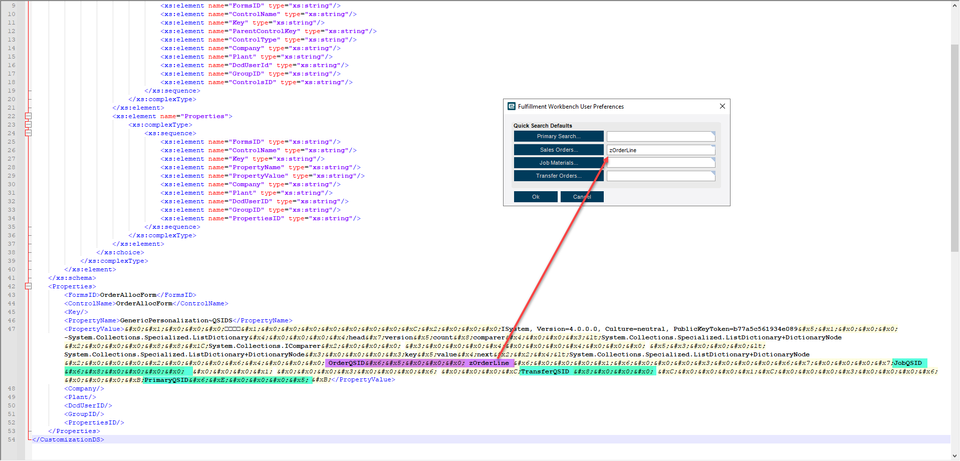

We have a quick search set for orders in the Fulfillment Workbench, but whenever we set the “Fulfillment Workbench user preferences->Quick Search Defaults” to the chosen Quick Search it replaces the base search.

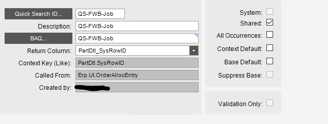

These are the settings of the Quick Search:

The Fulfillment Workbench is such a pain to work with and this is no exception. Instead of this living in the Ice.QuickSearch table, which would be global and easier to work with, it saves it as a personalization for the user in the Ice.XXXDef table.
Not much we can do there since it’s stored differently.
Someone else may be able to weigh in here, but I’d walk away from that if it were me.
Hi, thanks a lot for the response. I tried this earlier today. And while i managed to correctly update the personalization via a function, it still didnt work. I verified it via the customization maintenance screen. It looked the same as if I did it manually and still.
There must be something running in the background that I couldn’t find. I guess the next step would be to decompile the dll and see how epicor does it.
