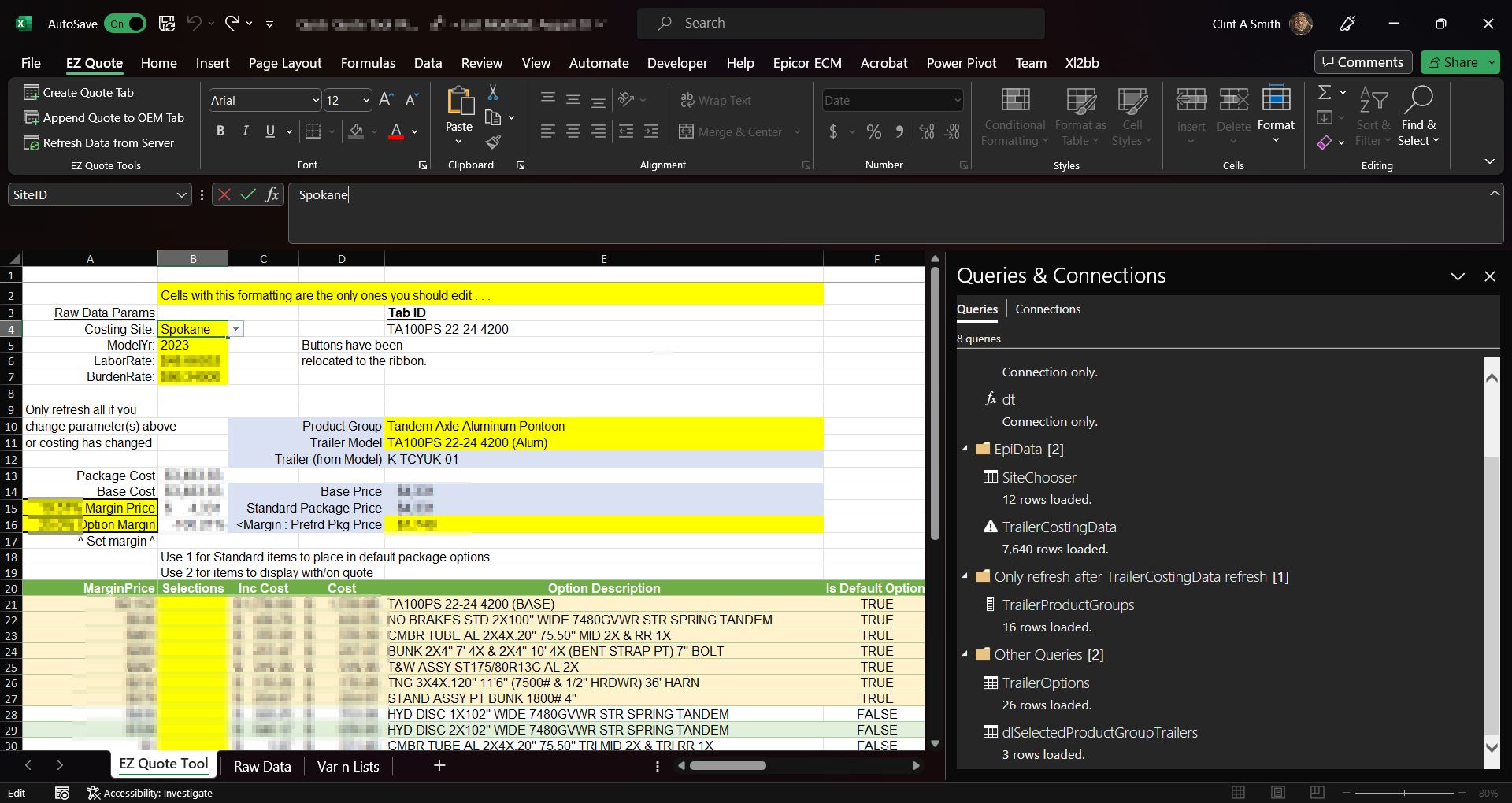

Not sure if this will help but, I have a External BAQ (tied to additional configurator table data in dbo table {I didnt make it}), but the logic should be similar for getting costing information (will need cte to go deeper but almost all full trailer assemblies were within $5 of cost most within $1). Mine only does the break down of top level phantom items into quote like costing info and assembling it into data for an Excel workbook. Lots of the data is simplified, but might help you get started.
Workbook (does allow for full costing data pull using parameters through odata) screenshot:
I will DM you the SQL as the BAQ won’t really work for you. Outside tables.
Most of this is with VB and dynamic lists tied to Power M query datasets.
