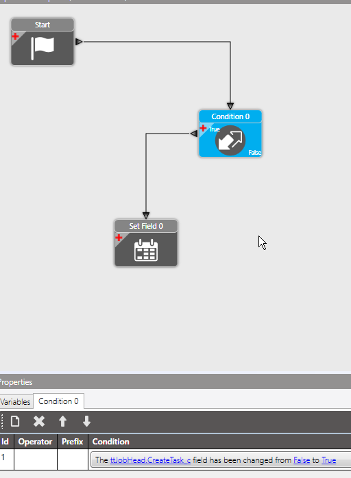

After looking at the Quote Header we have a UD Checkbox we are calling “Engineered”. Would you setup a UD date field that looks to the Checkbox and if checked use today and if blank no action? By using the Quote Entered Date and a date from when the “Engineered” checkbox is checked it will get me the time spread I am looking for. I would appreciate your or any ones thoughts on this.

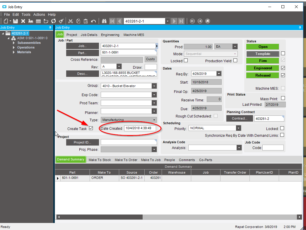

Whatever works. It’s just a condition algorithm. You set up what you need for your business. Just work the the logic and the what-ifs for however you could break it and make sure you handle the cases. We have a checkbox set up in Job entry to trigger an e-mail to get sent to our productivity software to automatically create a task. When is sees the checkbox change from false to true, it set’s the date created and sends the e-mail. You can set it up the same way, just skip the e-mail part. Our is set up to allow for unchecking and re-checking it and it will re-send the e-mail. You could just make it so once you check the box, the date is created, and if there is already a date, don’t allow the check box to be unchecked. Or whatever you need.

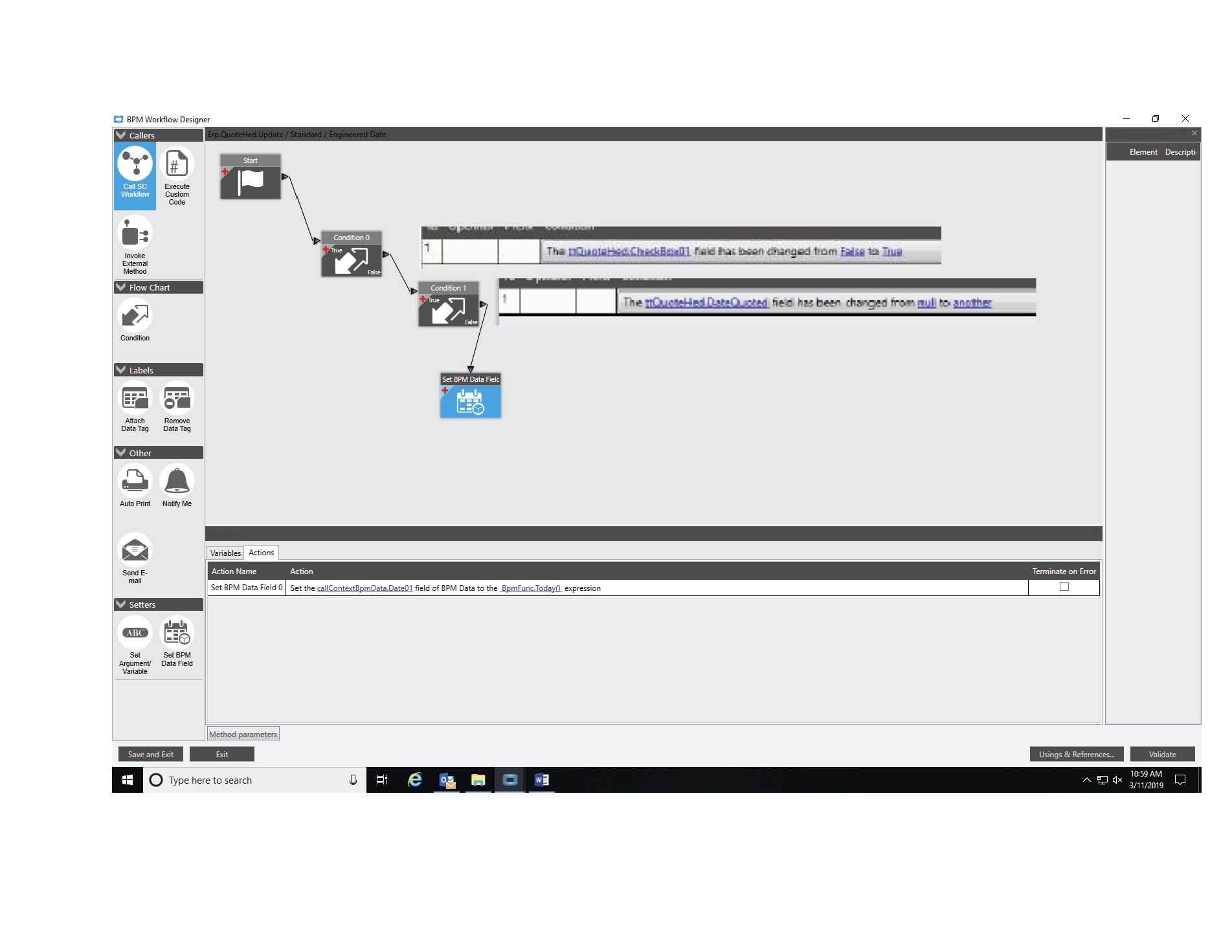

I have set up a data directive as shown. Am I missing anything on this?
well, you are coming out of the false side for those conditions. Is that intentional?
This was not intentional. I was not sure how to set the second condition field to look at the date field and if it had a date to not process. What should I have made this to state?
Maybe just start with the check box first, make sure that’s working.
Second, you are setting a BPM Data field. Don’t you want to set the actual field?
The “Set Field” was the part I did not know as I have never done this before. I will update the file to reflect this. This will cover the condition of the check box going from false to true but what condition do you include to look at the date field and not update if it is already populated? Thanks.
