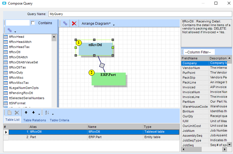

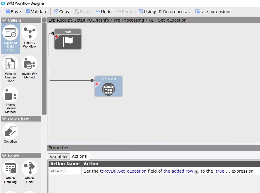

If I write a BPM:
//Epicor.Customization.Bpm.InfoMessage.Publish("Start");
foreach(var ttRcvDtl_xRow in (from ttRcvDtl_Row in ttRcvDtl
where ttRcvDtl_Row.Added()
select ttRcvDtl_Row).ToList())
var Part_xRow = (from Part_Row in Db.Part where Part_Row.Company == ttRcvDtl_xRow.Company && Part_Row.PartNum == ttRcvDtl_xRow.PartNum
select Part_Row).FirstOrDefault();
if (Part_xRow != null)
//Epicor.Customization.Bpm.InfoMessage.Publish("Found Part");
if ((bool)Part_xRow["NonStock"] == true);
//Epicor.Customization.Bpm.InfoMessage.Publish("Part NonStock");
ttRcvDtl_xRow["SetToLocation"] = true;
If the Part exists and NonStock = False - I get the Default Warehouse and Default Bin (user has to Click To Location)
If the Part exists and NonStock = True - I get the Default Warehouse and Default Bin
If the Part does not exist - I get the Default Warehouse and Default Bin

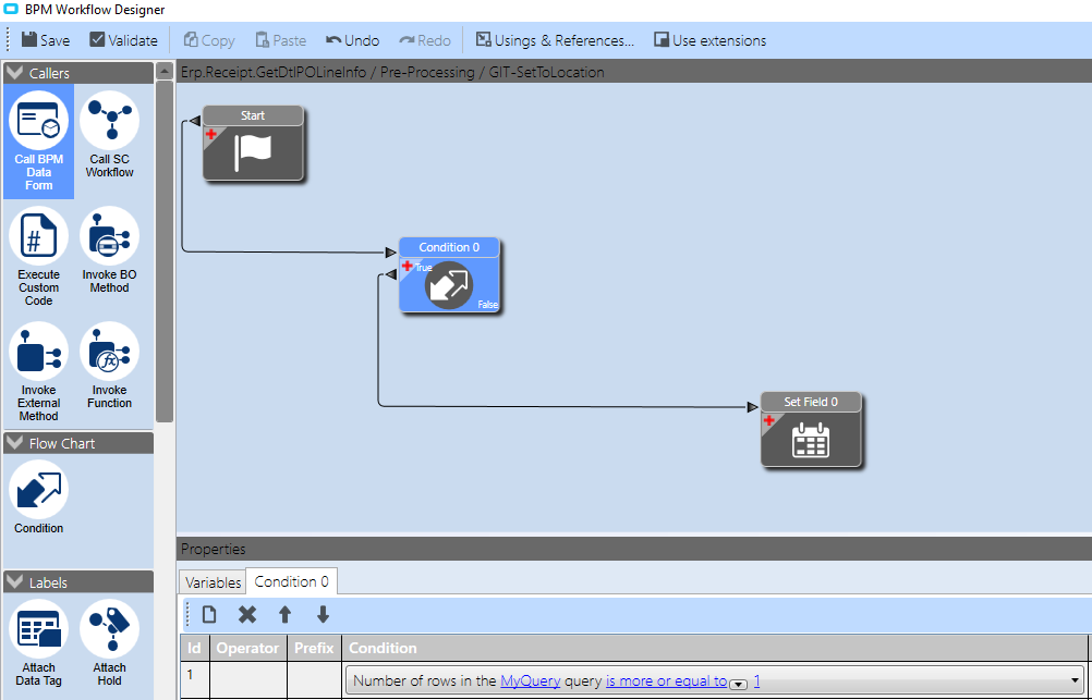

In the Method directives, create this bpm it should work fine.

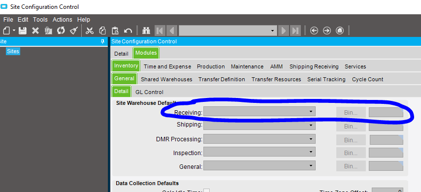

As per the standard functionality, if there no primary warehouse and bin then it will pick the details from the default receiving warehouse set in the site configuration.
@rppmorris
Kindly cross check the site maintenance, does the receiving warehouse is setup ?
If the answer is yes for the above question, then in the bpm put the condition non-stock = false.
The Non-Stock is not available as a field to add through the Widgets - so I tried to perform the action by firstly invoking the method then by coding - neither works.

Below is the condition which I have tested with.
I have both the stock and non-stock parts in the part master. Same set with primary warehouse and bin. Its working fine. If the part is on-the fly then it will default the warehouse set in the site.
