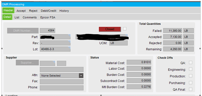

I found the issue. One of our DMR’s was closed with a remaining quantity of inventory. The DMR was reopened, our quality department rejected/returned the remaining inventory to our supplier, and the DMR was closed again. This solved the problem. When a DMR is closed with a remaining qty, the DMR GL will always be overstated when comparing to the DMR subledger (Open DMR Status Report).
I can’t think of any situation where a DMR should be closed with an existing remaining qty, so I submitted this example to epicor ideas. I’m hoping epicor will create a BPM that will prevent DMR’s from being closed until the “remaining qty” field has been cleared.
