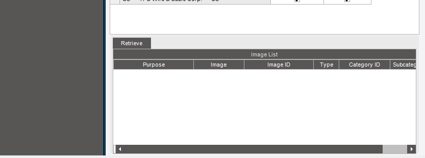

I have noticed an issue when trying to use the Report Style > Companies / Images > Retrieve feature.
The solution worked wonderfully when doing it for the Sales Order Acknowledgement report, but for some reason i cannot retrieve any images when i am trying to do the same thing for the QuotForm Report.
Anyone every encounter this issue? Not seeing any rhyme or reason why this wouldn’t work. I am on version: 10.2.500.18

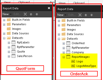

The Report’s RDL must have a “ReportImages” dataset. Here’s the QuotForm and OrderAck RDL’s, side-by-side:
Just add the dataset to the Quote’s RDL. Copy the properties from the original OrderAck RDL.

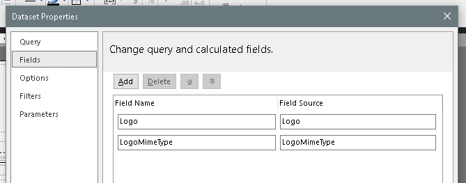

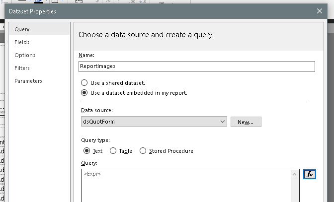

Here’s all the tabs of the added ReportImages dataset:

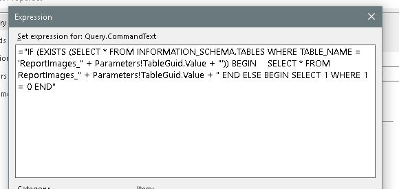

Query Expression:
No changes required in Options, Filters, or Parameters tabs

Now you double click the Images grid (after clicking Retrieve) to setup the image properties.
