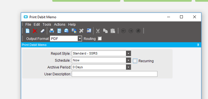

There’s an AP Debit memo program that COULD be added as a custom menu option. I added a menu option to Accounts Payable/Reports with the program Erp.UIRpt.APDebitMemoForm.dll. When I run that menu option, it doesn’t like it because it hasn’t identified the debit memo to print.
It’s likely that this could be added as a button to the A/P tracker program where it sets the parameters to the debit memo to be printed, then calls the print program. It would take some research to get what parameters Epicor uses in the programs. Not sure if anyone here has the launch form options that would need to be set??
I created a menu item with that program. Erp.UIRpt.APDebitMemoForm.dll.
Has anyone figured out how to pass the values into this menu item??
