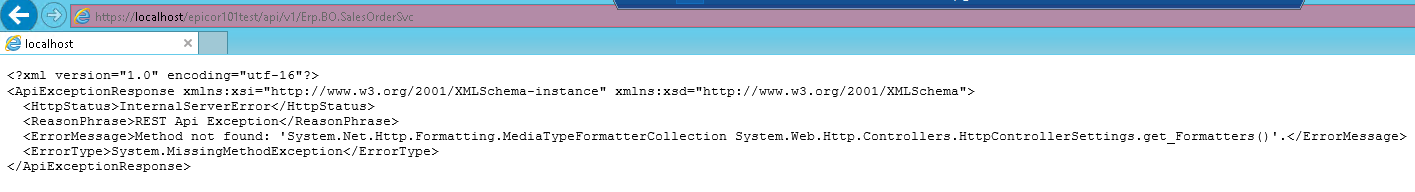

Has anyone seen this error before. All I did was check the checkbox in the admin console then clicked deploy. When I enter the URL as seen in the image below I get an error. Is there something I am overlooking here, documentation makes it seem very easy to setup.

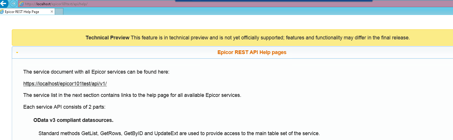

Yes, navigating to help works.

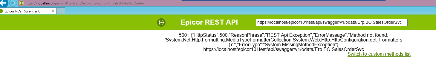

ok what about going through the help to some of the services?
Doesn’t work. I get this.
Method not found… hmmm yeah interesting… Try re-creating an app server… looks like since you did the checkbox after deployment it didn’t work correctly.
That made it work @josecgomez
