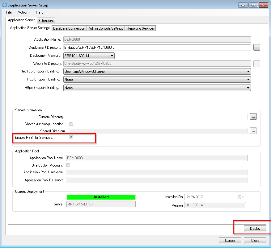

In the Epicor Administration Console (EAC) did you enable RESTFul service and deploy?
If you did this can you supply a screenshot of your bindings and how you are accessing (from a client or the server)
Hey guys thanks for the response. We did in fact enable RESTful services. I can provide screen shots on Tuesday when I’m back in office.
Sorry for the late response we’ve been swamped the past two days and haven’t had a chance to play with this again.
We are accessing from the server and
Here is our current bindings
Then after we set our bindings we configured SSL Settings on the ERP Application Server per Epicor Help - Rest Implementation - Activate and Configure REST

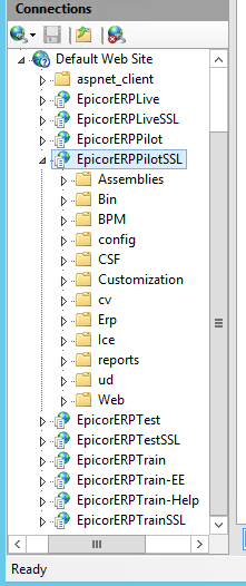

It’s actually an interesting conversation on deployment options. The default most folks are used to doing is that classic add a new app under the default web site
So for example, I have three instances on this VM:
But one rogue web.config as mentioned above can mess things up. Additionally, with the ability to bind many different DNS names to a single box via Site Binding, it is making me start to look at an ERP instance per site a lot more.
Example:
This cleans up the sysconfig settings as well. Some interesting options…
