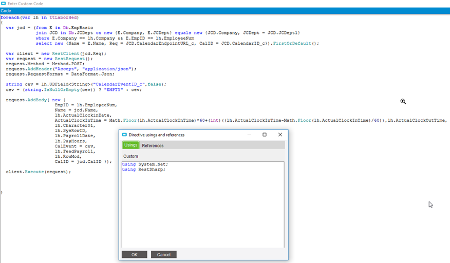

Here’s what it looks like.
Awesome, thank you for sharing!!!

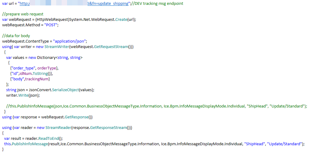

I’m actually just working on this as we speak. In this case, I’m not writing back to Epicor from the response (pulling files down from S3 to file server and then updating an Epicor rec), but I can provide you with an example webhook that I’ve used in the past.
This code POSTs data, but you could use it for a GET as well.
You could read the response of the StreamReader and then write back to Epicor from there.
