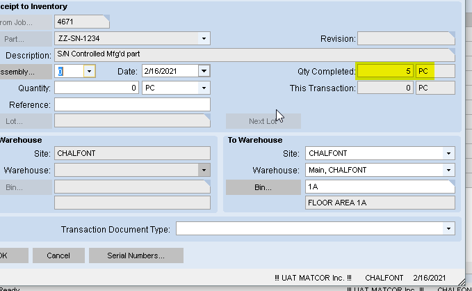

When I try this I get an error message
Does a non-zero value show in the Qty Completed box?
I found out the material manager was doing the same thing I was. It’s good now.
