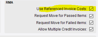

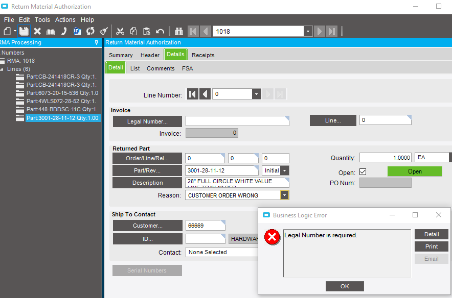

We have large retail accounts that send in a truckload of return material that may have been sold on many different sales orders which can also have multiple invoices attached. Has anyone created RMA’s in core Epicor from an EDI file and did you receive all related information from the customer or did you have to manipulate the file to include the data that is required in the RMA processing screen. We are trying to get away from an outside running custom DB that does not have the proper hooks for the financial piece and run our RMA totally thru Epicor. Right now the Customer is only giving us the parts and quantities and a few other small items in an EDI file. No invoice number or sales order is being supplied.
Can you share you RMA process for large retail customer returns
