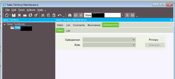

Hi,
Upon checking, the salesperson is not assigned to this state.
2019-04-25_9-08-25
Please advise if this is due to this issue or BPM?

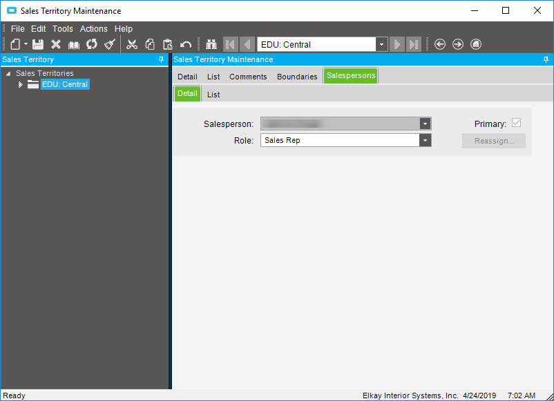

I’m going to assume that the Territory is not active as there is no salesperson assigned.
You need to set up the Territory with the Salesperson to have it populate on the SO. Do that and see if it fixes the issue.
