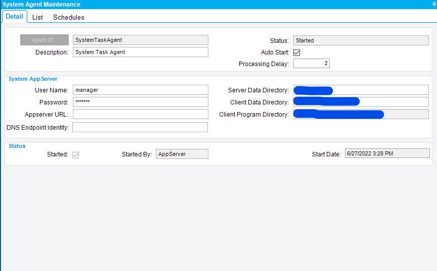

If you open up your System Task Agent screen – can you send us a screenshot, you can blur out server url.
This one?
Is the screenshot from Pilot or Test? I think those maybe where the issue is.
