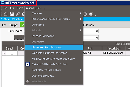

If you do it with DMT, it’ll take. Been there.
Occasionally I’ve had to use the Fulfillment Workbench to clear allocations, reservations, etc…
What steps have you used successfully to ‘fix’ this via Fulfillment Workbench? We occasionally run into this situation and have not been able to make any difference using any actions from Fulfillment Workbench.
Hey Jason,
Did you have any specific instructions on how to go about this? I’ve recently come across the same error after making a UBAQ and we’ve now tried DMT as well and come across the same error.
This is the DMT I use for Order Detail:
Company OrderNum OrderLine PartNum ProdCode
abc 63983 17 910836 PDCPARTS
abc 64071 7 20077 PDCPARTS
abc 64115 6 60114 PDCPARTS
abc 64173 80 621507 PDCPTINT
Obviously change the data to fit your situation.
That’s it.
